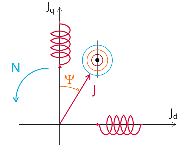

The aim of the test “ Working point – Sine wave – Generator – I, Ψ, N” is to characterize the behavior of the machine when operating at the targeted input values I, Ψ, N (Magnitude of current, Control angle, Speed).
These three inputs are enough to impose a precise working point.
| “Working point – Sine wave – Generator – I, Ψ, N” illustration |
