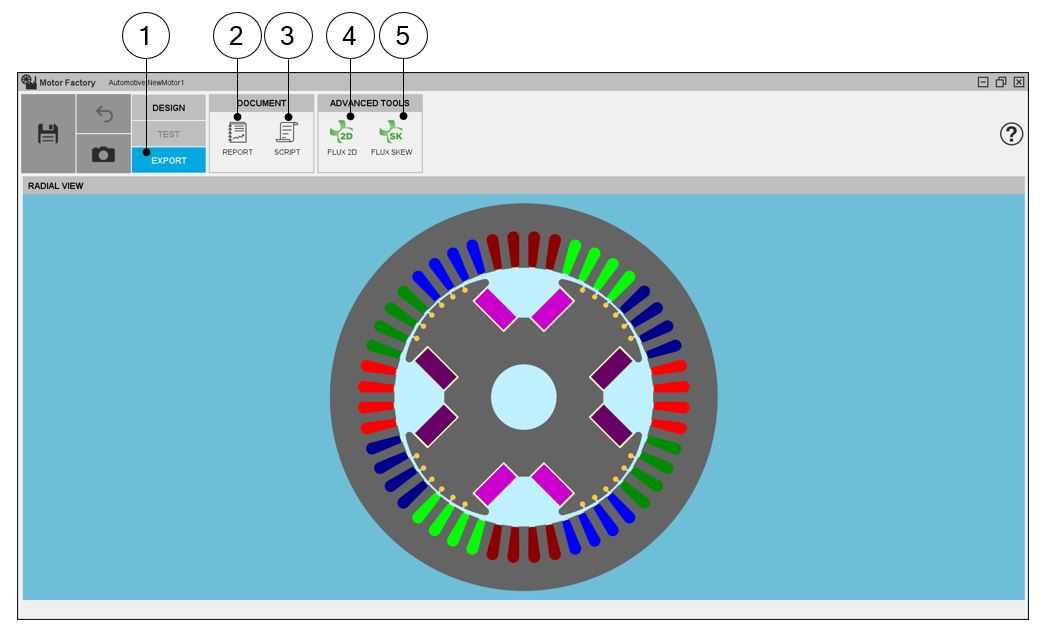

In “DOCUMENT”, the function “REPORT” allows building reports automatically to describe all the work achieved for the design as well as for the tests.
Then, the function “SCRIPT” allows to build and export a python script of a current motor in the application Script Factory or in a targeted folder.
- “ADVANCED TOOLS “
In “ADVANCED TOOLS”, the functions “FLUX 2D” and FLUX SKEW allow to build and export a model in Altair® Flux® environment (2D, or Skew) for performing advanced studies either with magneto static or transient applications.
| Motor Factory - EXPORT area | |
| 1 | Selection of the EXPORT area of Motor Factory. |
| 2 | Access the area “REPORT” in which a report can be made |
| 3 | Access the area “SCRIPT” for generating a python file in which all the needed command lines are written to rebuild the motor |
| 4 | Access the area “FLUX2D” in which a model can be made and sent to Altair® Flux® 2D |
| 5 | Access the area “FLUX SKEW” in which a model can be made and sent to Flux® Skew |
