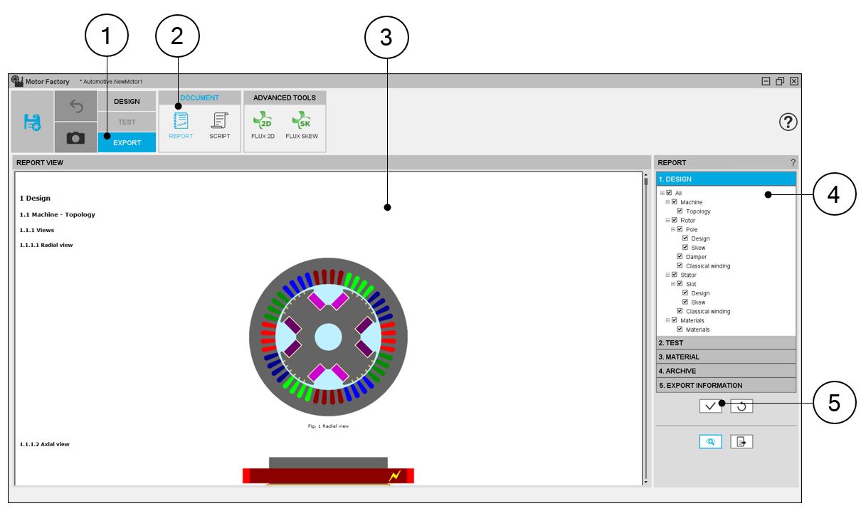

| Motor Factory – EXPORT AREA – Export a report | |
| 1 | Selection of the EXPORT area of Motor Factory. |
| 2 | Access the area in which a report can be made |
| 3 | Zone to visualize the report (= preview) |
| 4 | 5 steps to build the report which user need |
| 5 | Buttons to validate inputs, display a preview and export a report |
Steps to build and export a report.
Five steps are needed to build and export a report: In EXPORT / DOCUMENT / REPORT
area
- Select the sections to write dealing with the design.
- Select the sections to write dealing with the tests.
- Select the sections to write dealing with the materials.
- Select the “saved test results” you want to add as archive in the report.
- Define the export information.
