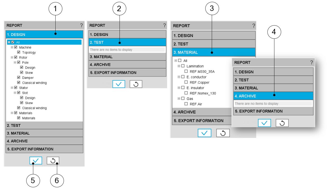

Inputs
List of sections available to build the report
| Motor Factory - EXPORT AREA – Export a report – Chapters to be selected | |
| 1 | Chapters to describe the DESIGN. Machine, Rotor and Stator characteristics. |
| 2 |
Chapters to describe the TEST results. (TEST will be available in the next versions) All the test results are available as soon as the corresponding computations are performed. |
| 3 | List of materials used to build the machine can be added to the report with all their physical properties. |
| 4 | Archive groups all the tests which have been saved during the
process. These can be added to the report. Note: A
maximum of five results per test can be added to the
report. |
| 5 | Button to apply the selection of the user input selections (selection of chapters) |
| 6 | Button to restore default values. |

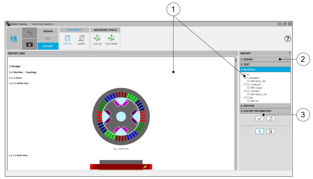

Selection of sections
| 1 | Section names are shortcuts for displaying the corresponding section
of the report:DESIGN, TEST, MATERIAL, ARCHIVE, EXPORT INFORMATION. Note: TEST and ARCHIVE will be available later when
one will be able to perform tests dedicated to Wound field
synchronous machines in Motor Factory. |
| 2 | Check the section to add chapters to the report |
| 3 | Button “Preview” considers the selected chapters and displays the report |

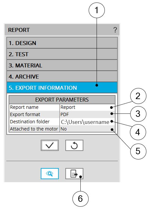

Export information
| Motor Factory - EXPORT AREA – Export a report – Export information | |
| 1 | Access to the area in which export parameters can be defined |
| 2 | A file name must be written (Default name = “Report”) |
| 3 | The file format must be chosen (pdf or html) to build the report |
| 4 | A folder in which storing the report must be selected via the browser |
| 5 | It is possible to attach the report (HTML or PDF file) to the motor in the “Motor Catalog” |
| 6 | Button to export the report by considering all the previous defined parameters |
