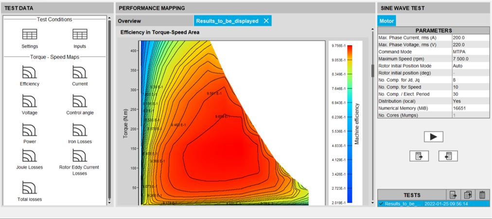

The aim of the test “Performance mapping – Sine wave – Motor – Efficiency map - FeMT” is
to characterize the machine efficiency map, launching a set of transient simulations
which allows very high accuracy.
Note: This test is not available
for polyphase machines.
The resulting model is fully parameterized, and it is built in Flux® 2D environment, transient application. To run this test, Flux® 2D offers a dedicated toolbox called Flux e-Machine Toolbox (FeMT), which automatically manage the set of simulations and their postprocessing to build complete and accurate maps.
Through this export, the users will obtain a FeMT project ready to be solved. Additionally, the Flux® 2D project used by FeMT is also available.
Note: It should be noted that, even if the export process is quite
fast, the simulation in FeMT is based on a big set of transient simulations, that
usually requires a high computation time. For more information, refer to FeMT Help.
