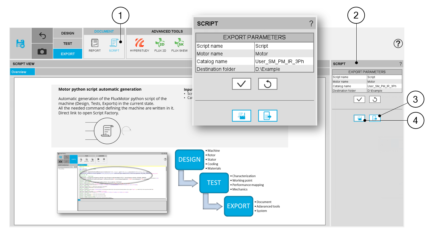

| Motor Factory – EXPORT AREA – Export a python script | |
| 1 | In Motor Factory select EXPORT / SCRIPT environment. |
| 2 | The EXPORT / SCRIPT environment user input allows to define the
name and the location of the new script file + the name of the motor
to be rebuilt from the new python script file, with the catalog name
in which it will be stored. Note: Without
defining other names for the motor and/or the catalog, the
original motor would be overwritten while running the new python
script file. |
| 3 | Button to build and to export the resulting python file. |
| 4 | Button to build and to export the resulting python file, and then to open it directly and automatically in Script Factory |
