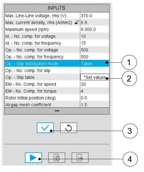

| Slip distribution mode = Table | |
| 1 | Select the “Table” option. |
| 2 | Click the button “Set values” of the field “Slip table” to open a dialog box defining the list of slips to be considered. Refer to the next illustration which shows how to fill the Slip table. |
| 3 | Button to validate and consider the user inputs |
| 4 | Button to run the computation |

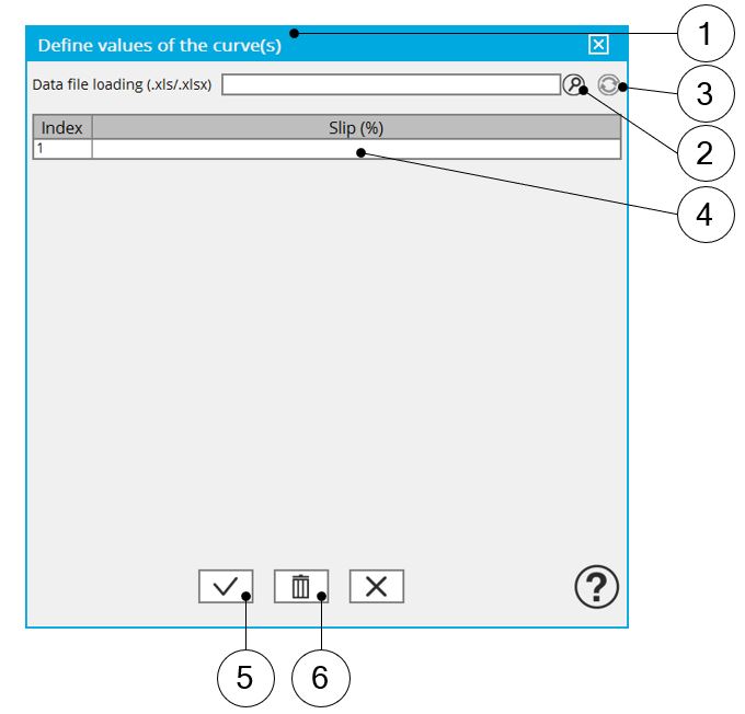

| Slip distribution mode = Table – Dialog box to define the list of slips | |
| 1 | Dialog box opened when clicking on the button “Set values” in the field “Slip table” |
| 2 | Browse the folder to select an Excel file which defines the list of slips |
| 3 | Button to refresh the table data when the considered Excel file has been modified |
| 4 | Fields to be filled with data to describe the considered slips |
| 5 | Button to apply the inputs |
| 6 | Button to erase the data table |

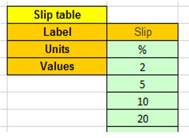

| Excel file template to define the list of slips |
- The slips must be listed in ascending order.
- We recommend defining at least 100 values to get an accuracy high enough, (especially since going below 100 does not lead to a significant reduction in computation time).

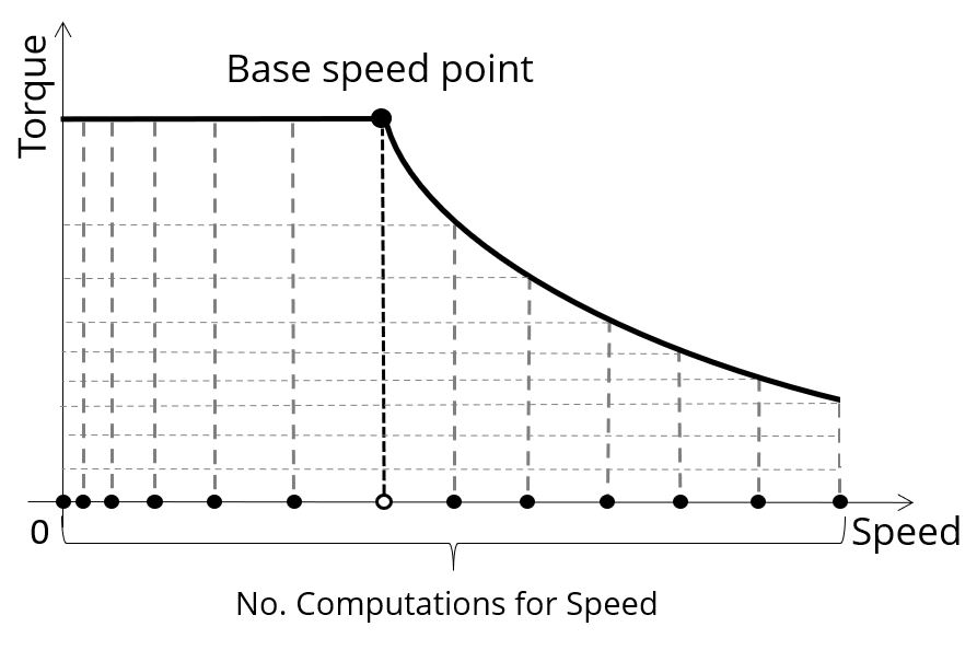

EM - Number of computations for speed
The “EM - No. comp. for speed” (Efficiency map - Number of computations for speed) corresponds to the number of points to be considered in the speed range from 0 to the maximum speed.
Half of these points are distributed from 0 to the base speed. The remaining points are distributed from the base speed to the maximum speed.
| Definition of the number of computations for speed |

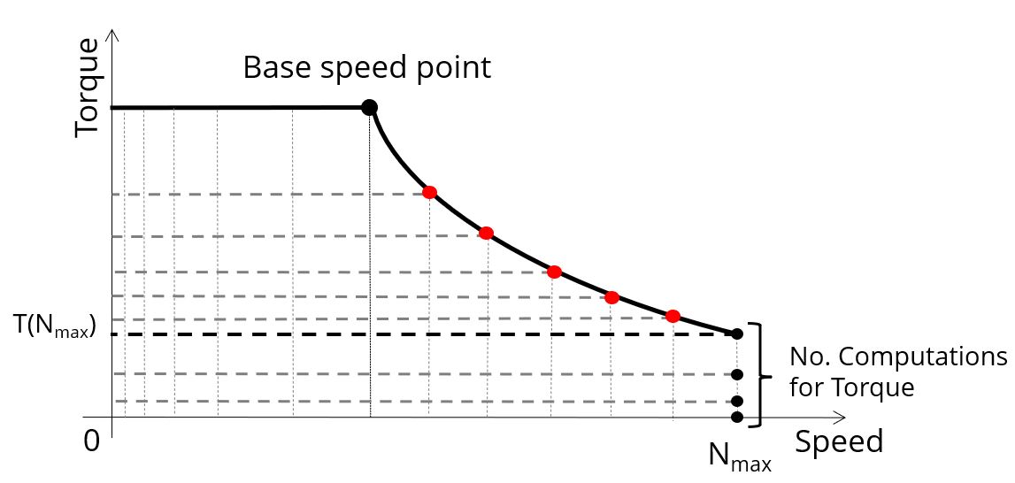

EM - Number of computations for torque
For the speed range [Nbase; Nmax.], the number of computations for torque is imposed by the number of computations for the defined speed range [Nbase; Nmax.] (Red points in the image shown below).
The advanced user input parameter “EM - No. comp. for torque” (Efficiency map - Number of computations for torque) allows to finalize the grid within the torque range [0, T (Nmax.)] at the maximum speed (Black points in the image shown below).
| Definition of the number of computations for torque |
