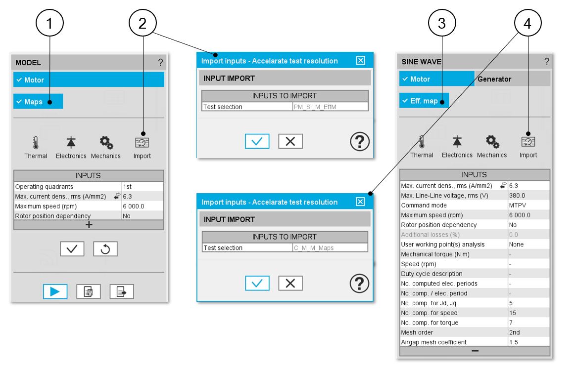

Upon completing a model map test, users can activate the import button in the efficiency map test GUI. This enables them to effortlessly import the settings and corresponding Flux data from the previous test, eliminating the need to rerun Flux for identical data, a step that typically consumes a substantial portion of computation time during efficiency mapping.
| Import function in Model Map test and
Efficiency Map test to accelerate test resolution. Example for Wound field synchronous machines |
| 1 | Open model map test environment when an efficiency map test is available for import |
| 2 | Click the import button and import the settings, inputs, and Flux data of the latest efficiency map test |
| 3 | Open efficiency map test environment when a model map test is available for import |
| 4 | Click the import button and import the settings, inputs, and Flux data of the latest model map test |
