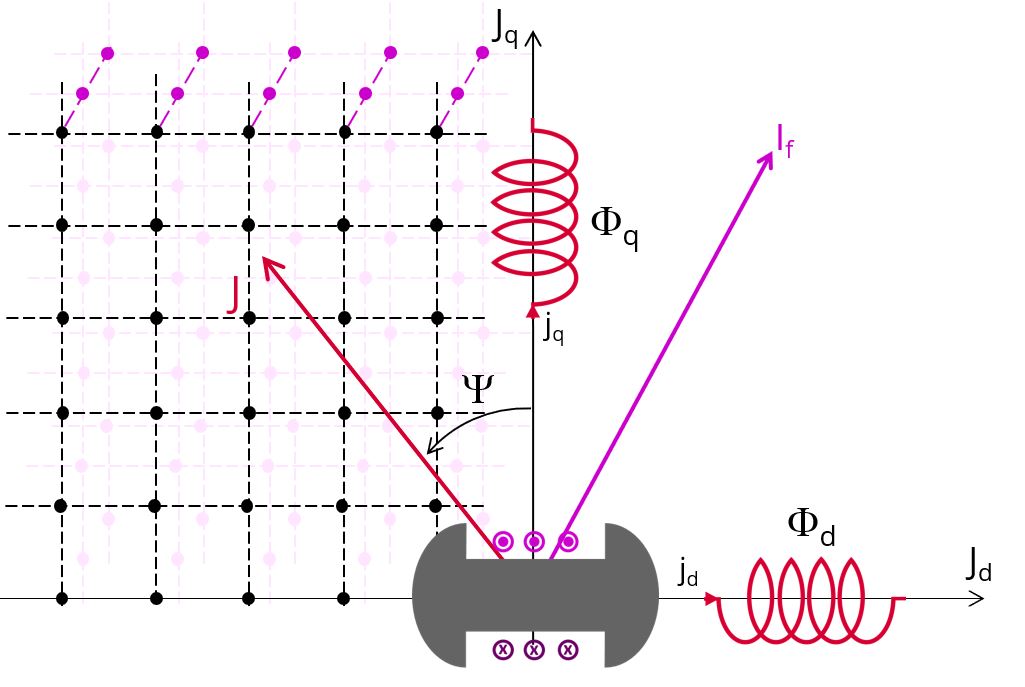

The aim of the test “Characterization - Model - Motor - Maps” is to give maps along the three dimensions, If-Jd-Jq, for characterizing the 3-Phase synchronous machines with wound field.
These maps allow for predicting the behavior of the electrical rotating machine at a system level.
| “Characterization - Model - Motor - Maps” illustration. Example for a second quadrant calculus. |
The performance of the machine in steady state can be deduced from the results obtained in this test in association with the drive and control mode to be considered.
