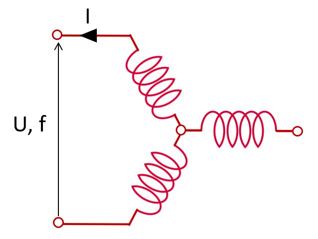

SSFR voltage, rms
The rms value of the SSFR voltage “SSFR voltage, rms” (Voltage between two terminals during SSFR test, rms value) must be provided.
- The number of parallel paths is automatically considered in the results.
- The test is always operated by considering a star winding connection.
By default, this input is equal to 0.2 V.
The test procedure for performing the SSFR test consists in applying a fixed low voltage source between two terminals of the machine armature winding (Star winding connection) over a range of frequencies. SSFR voltage corresponds to the voltage source (U) applied.
For additional information please refer to the main principles of computation section.
| SSFR voltage (U) applied between two terminals of the machine armature winding |

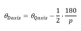

Rotor initial position
The computations are performed by considering the relative angular position between the rotor and stator.
This relative angular position corresponds to the angular distance between the direct axis of the rotor north pole and the axis of the stator phase 1 (reference phase).
With p = number of pole pairs of the machine.
