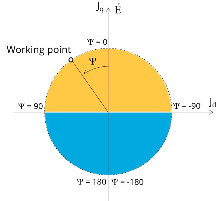

Number of computations for control angle
Considering the vector diagram shown below, the “Control angle” is the angle between the electromotive force (E) and the electrical current (J) (Ψ= angle (E, J)).
| Definition of the control angle Ψ |
In the backend of FluxMotor, the control angle is varied within a research zone to find the value allows achieving the desired working point P-Pf-U-N. This research zone is discretized linearly based on the “Number of computations for control angle.”

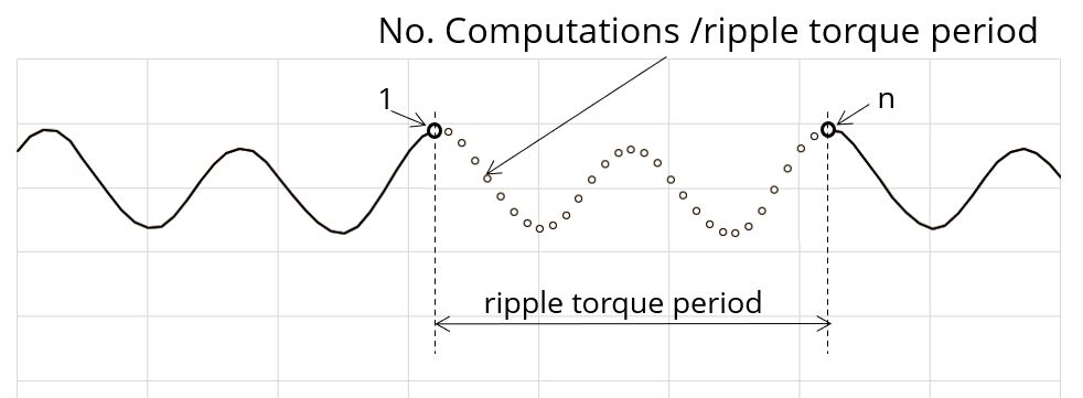

Number of computations per ripple torque period
The number of computations per ripple torque period is considered when the user has chosen to perform a “Ripple torque analysis” (i.e., answered “Yes” to the standard input “Ripple torque analysis” required only with “Fast” computation mode).
The user input “No. comp. / ripple period” (Number of computations per ripple torque period) influences the accuracy of the results (computation of the peak-peak ripple torque) and the computation time.
The default value is equal to 30. The minimum allowed value is 25. The default value provides a good balance between the accuracy of results and computation time.
| Definition of the number of computations per ripple torque period |
