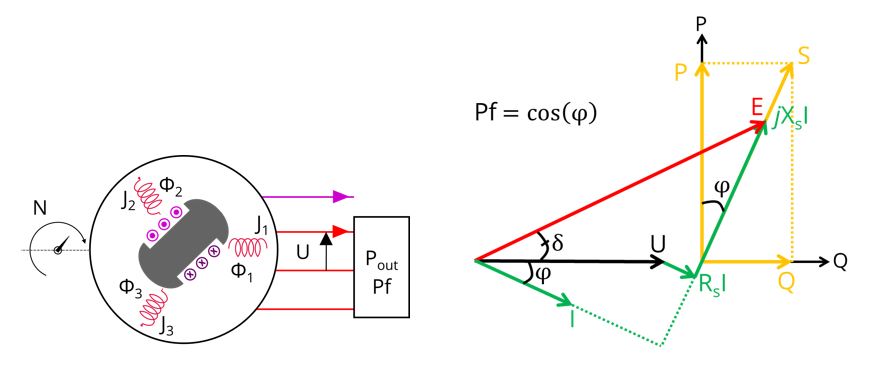

The aim of the test “Working point – Sine wave – Motor & Generator – P, Pf, U, N”
is to characterize the behavior of the machine when operating at the working point
that is targeted by the user. This point is defined by:
- the output power which can be either the electrical power transmitted to the stator winding if the machine is in generator operation, or the mechanical power exerted on the shaft if the machine is in motor operation. If the generator operation is targeted, the output power can be replaced by the apparent power.
- the power factor,
- the line-line voltage,
- and the rotating speed.
Through this test, the user can also verify whether the desired operating point is compatible with the machine. Additionally, the user can identify the appropriate reference values for the field current and the control angle needed to achieve this operating point.
