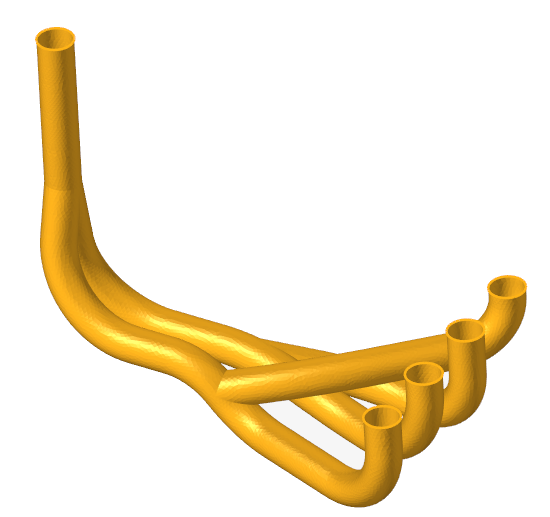

Assign Material Properties
Figure 8.
- Select the exhaust volume.

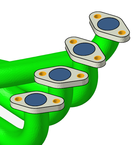

Figure 17.
Select the wall flanges.
Figure 18.
Note: Make sure you select the bottom and side surfaces of the flanges. In total, 12 surfaces should be selected. -

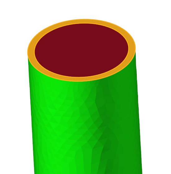

Select the outlet end.
Figure 21.
- In the microdialog, click the Temperature tab and assign the same parameters as the wall flanges and bolts.
Click
on the guide bar.
- Using the Boundaries legend, rename the surface group to Outlet_End.

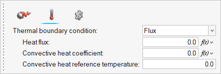

Hide all previously assigned surfaces then select the remaining surface.
Figure 23.
Check that default values are assigned to the thermal boundary
conditions.
