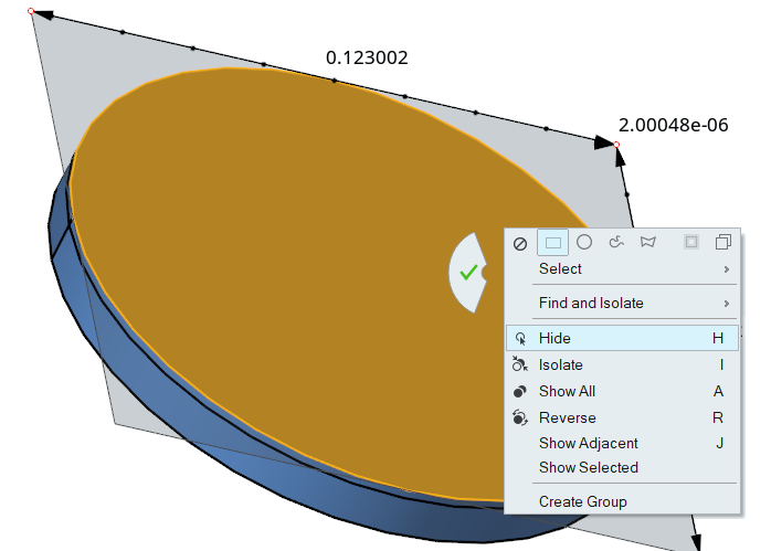

Select the surface highlighted in the figure below and hide it by pressing the
H key or by right-clicking and select
Hide from the context menu.

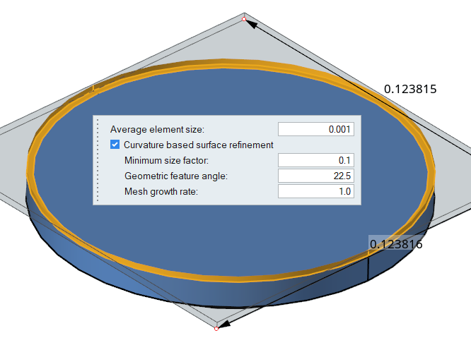

- Select the three surfaces highlighted in the figure below.
In the microdialog, set the Average element size to
0.001 and the Mesh growth rate to
1.
Figure 48.

- Activate the Enable surface mesh modification option
Figure 50.
On the guide bar, click
to execute
- Turn on the display of all the surfaces.
