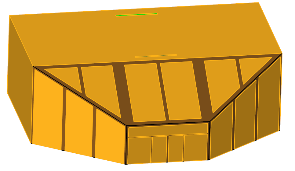

In the modeling window, select the four surfaces
highlighted in the image below.
Figure 15.
- In the microdialog, set the Layer thickness to 0.025 and the Material to Aluminum.
On the guide bar, verify that the number of Parent
Surfaces selected is 4 then click
to execute the
command.
Once the command is executed, the legend should be updated accordingly to reflect the changes. - Save the model.

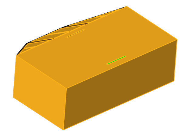

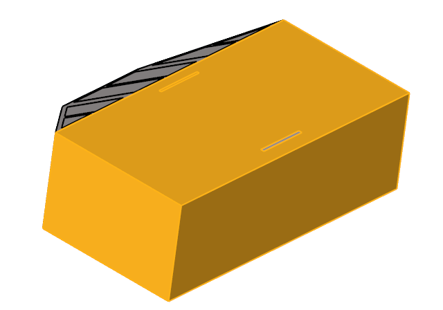

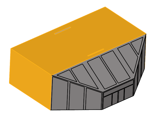

Select the three wall surfaces, the inlet, and the roof surface, as highlighted
in the figures below.
Figure 37. Front-Side of the Model
Figure 38. Back-Side of the Model
In the microdialog, set the Solar radiation model to
BB out then click
on the guide bar.

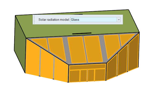

Select all the glass surfaces shown in the figure below, assign the
Glass model to them, then click
on the guide bar.

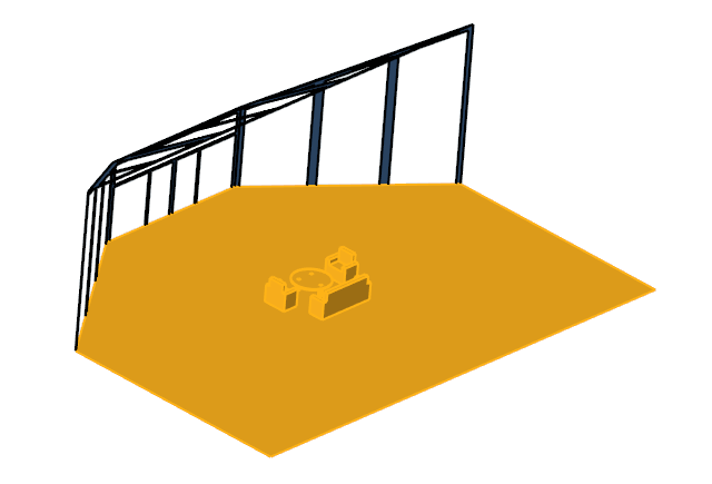

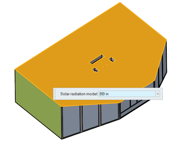

Rotate the model and select the floor surface. In the microdialog, assign the BB in model
then click
on the guide bar.
Figure 40.

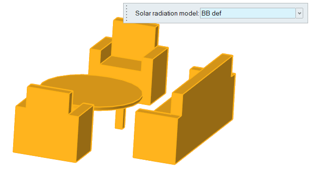

- From the Solar Radiation Model legend, right-click on Unassigned and select Isolate.
Select the surfaces of the couch, table, and chairs, assign the BB
def model to them, then click
on the guide bar.

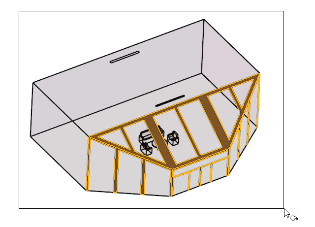

- On the guide bar, change the selection entity to Thin Solids.
Using the window selection method, select the four thin solid surfaces and
assign the BB out model to them.
Figure 42.
On the guide bar, verify that the Direction is set to
Away from Parent Surface then click
to execute
the changes.
