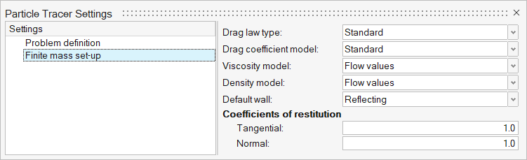

Click Finite mass set-up and leave all the parameters as
shown below.
Figure 40.

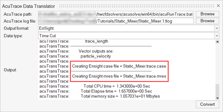

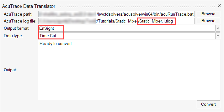

Convert Results for Ensight
Click the Convert tool.
Figure 55.
The AcuTrace Data Translator window opens. - Browse to the location where the AcuTrace log file (*.tlog) is located.
- Set the Output format to Ensight.
Set Data type to Time Cut.
Figure 56.
Click Convert.
Once the conversion is successful, it generates two Ensight result files.
Figure 57.
