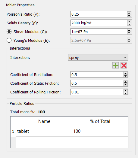

Click the tablet bulk material and verify that the
properties are set as shown below.
Figure 5.

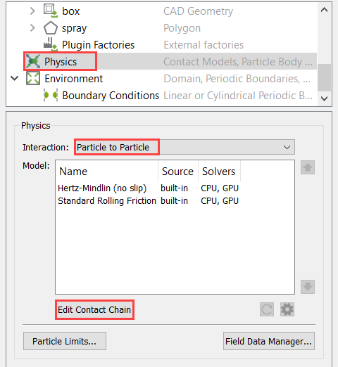

In the Creator Tree, click Physics.
Set the Interaction to Particle to Particle then click
Edit Contact Chain.
Figure 7.

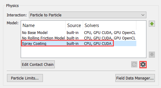

In the Creator Tree, select Spray Coating and then click
Figure 9.
In the Spray Coating Model Configuration dialog, click
, select spray from the list
of materials, and then click OK.

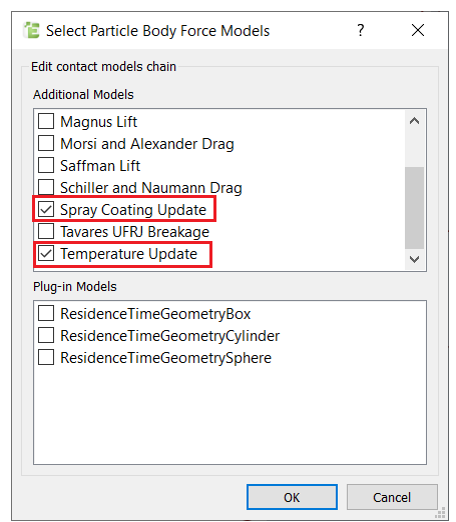

In the dialog, activate the checkboxes for Temperature
Update and Spray Coating Update and then
click OK.
Figure 12. By including the spray coating model in the particle body force, the
target material’s volume is updated. Without this, only the target material’s
Volume Added property will increase.

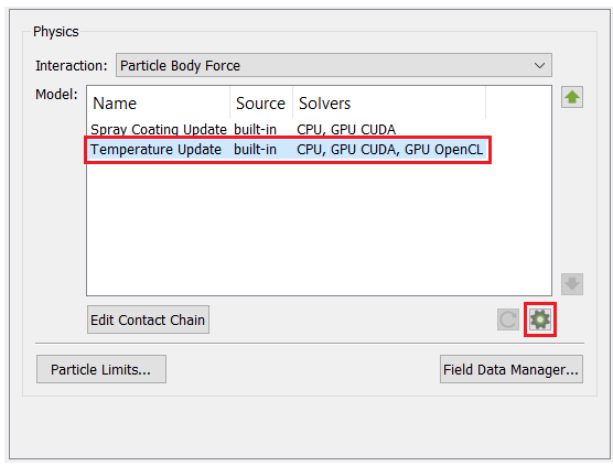

In the Creator Tree, select Temperature Update and then
click .
Figure 13.
Set the specific heat capacity of tablet and spray to
1200 and 4000 J/kg-K,
respectively, and then click OK.

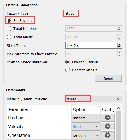

Right-click box and select Add Factory > Add Static Factory.
Figure 14.

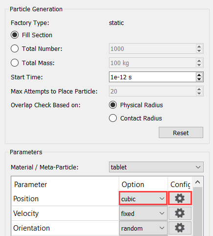

Set the particle generation parameters as shown in the figure below. Make sure
that the Material/Meta-Particle is set to tablet.
Figure 15.
Under Parameters, set the Position option to cubic and
then click .
Figure 16.

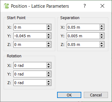

In the dialog, enter the position parameters as shown in the figure below and
then click OK.
This creates a row of tablet particles spaced evenly along the y-axis
and located at the center of the box.Figure 17.

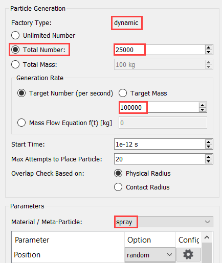

Right-click spray and select Add Factory > Add Dynamic Factory.
Set the particle generation parameters as shown in the figure below. Set the
Material to spray.
Figure 18.
