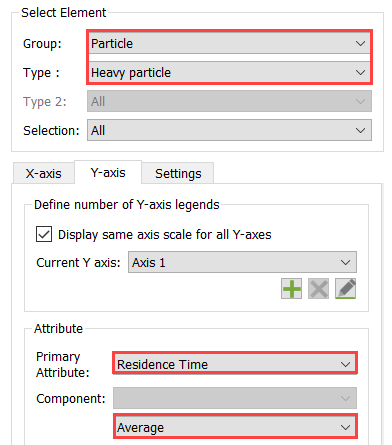

Click the Y-axis tab. Create a plot of average residence
time of the heavy particle over the simulation time by setting the values as
shown in the figure below.
Figure 60.

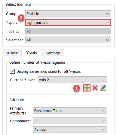

Click
to add another Y-axis and set
the Type to Light particle.
Figure 61.
Leave all the other options unchanged and then click Create
Graph to create a plot of average residence time of both the
particles.
Figure 62.
