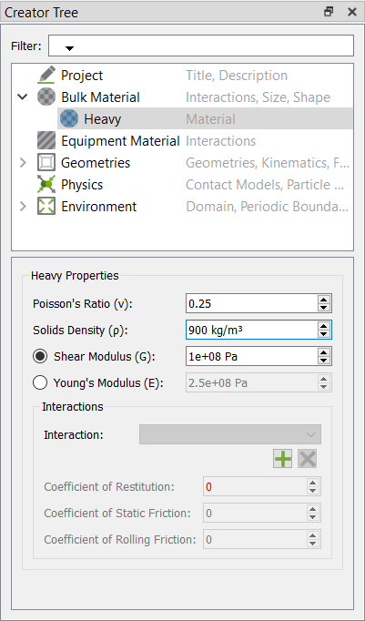

- In the Creator Tree, right-click Bulk Material and select Add Bulk Material.
- Rename the material to Heavy.
In the Creator Tree, set the Solids Density property to
900 kg/m3.
You will use the default values for other properties for this tutorial.

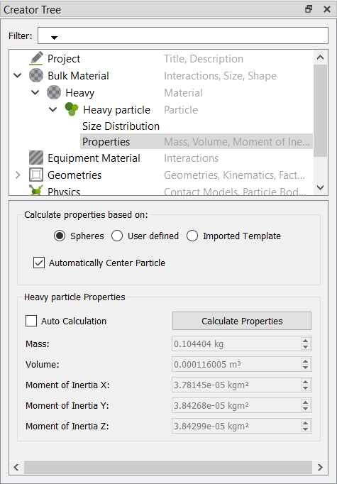

- In the Creator Tree, right click Heavy and select .
- Rename the particle to Heavy particle.
- Under Heavy particle, click Properties.
In the Heavy particle Spheres panel, set the Physical Radius of both the
spheres to 0.03 m and press Enter.
Figure 24.
In the Creator Tree, click Calculate Properties.

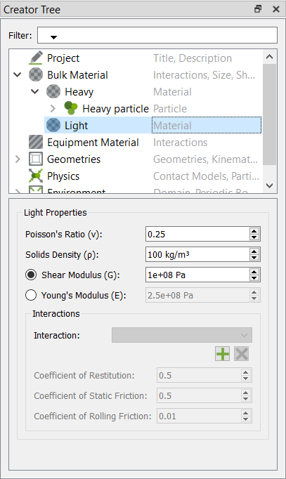

- Rename the material to Light.
100 kg/m3.

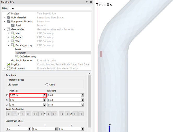

Under Particle_factory, click Transform. Set the
X-Position to 0.035 m
Figure 30.
Note: Set the Opacity value to 0.2 to see the transformed surface location inside the pipe geometry.This is done to make sure that the particles are generated inside the fluid domain.

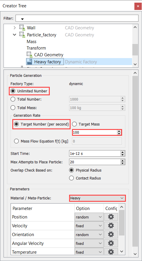

- In the Creator Tree, right-click on Particle_factory and select Add Factory.
- Rename the new factory to Heavy factory.
Set the particle generation parameters as shown in the figure below.
Figure 36.
Click
besides Velocity, set the
X-velocity to 1 m/s, then click
OK.
Click
besides Temperature, set the value to
363 K, then click OK.

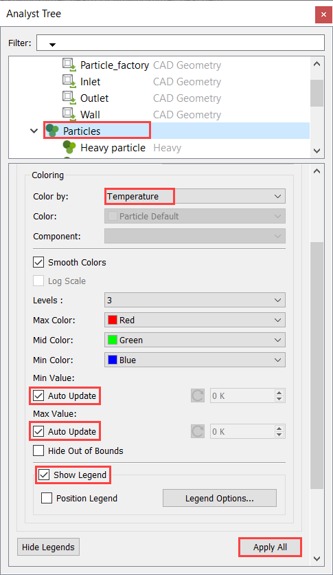

- In the Analyst Tree, click Particles.
- Set the coloring to Temperature.
- Activate the Auto Update checkboxes for both the Min and Max Value.
- Activate the Show Legend checkbox.
Click Apply All.
Figure 53.
