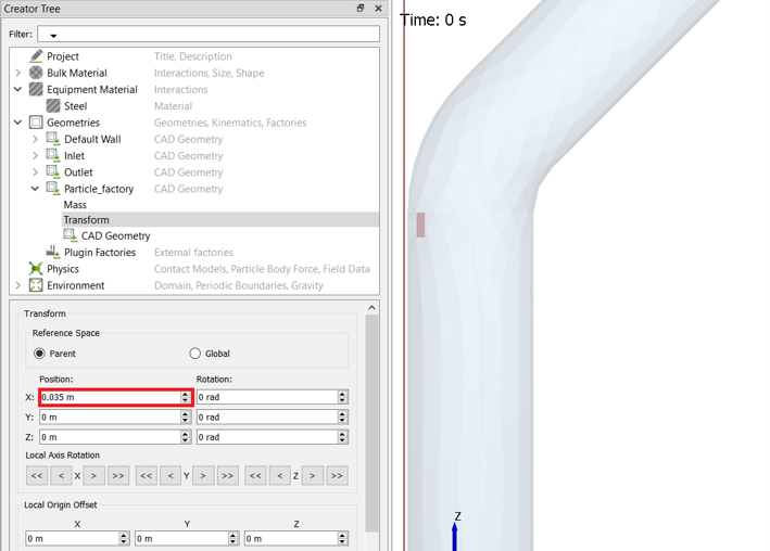

Under Particle_factory, click Transform. Set the
X-Position to 0.035 m
Figure 34.
Note: Set the Opacity value to 0.2 to see the transformed surface location inside the pipe geometry.This is done to make sure that the particles are generated inside the fluid domain.

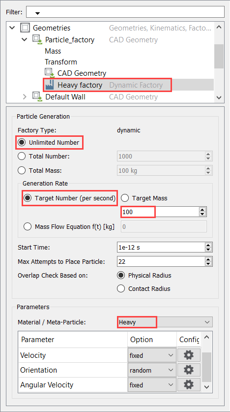

Now that the bulk material, geometry sections, and equipment materials are defined, you need to create a particle factory to generate the particles. You will create one factory for each bulk material.
- In the Creator Tree, right-click Particle_factory and select Add Factory.
- Rename the new factory to Heavy factory.
Set the particle generation parameters as shown in the figure below.
Figure 35.
Click
besides Velocity, set the
X-velocity to 1 m/s, and then click OK.
- Repeat steps 1-4 to create another factory named Light factory using the same parameters but with Light as the Material.
