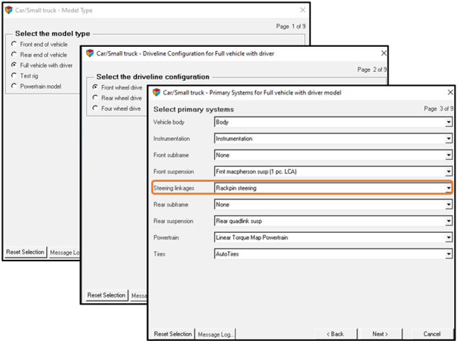

Create a Full Vehicle Model with EPAS System
The MBD-Vehicle Dynamics Tools must be loaded as a preference file.
The Update Model utility is only available when the profile MBD-Vehicle Dynamics Tools is loaded. Follow the steps below to load this profile and access the utility:
From the Menu bar, select
Figure 8.
Choose the MBD-Vehicle Dynamics Tools profile and click
Load.
Figure 9.
Click
Figure 10.
In the Model Type window, select the following:

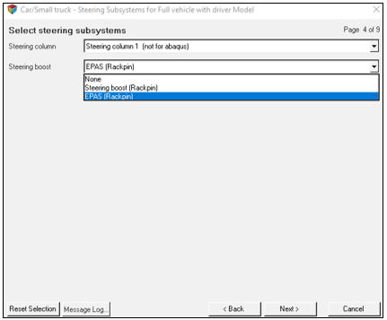

In steering subsystems EPAS (Rackpin) will be available
as a Steering boost method.
Figure 12.
Other options for the model systems are left to your discretion.
Completing the Assembly Wizard’s selections will lead to a full vehicle model with Altair Driver and an Electric Power Assisted Steering System.Figure 13.
