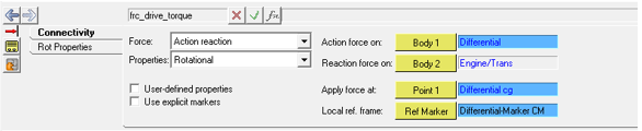

- Differential Torque or Drive Torque: Torque output of the powertrain.Figure 4.

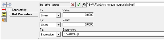

 Figure 5.
 Tz – Expression = ‘-1*VARVAL({Torque Output Solver Variable IDstring})’
