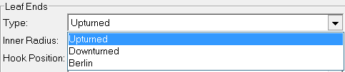

Spring Eye
- Type
- Defines the type of spring eye.
Figure 3. Available selections for spring eye
- Upturned
- Downturned
- Berlin
- Upturned
- Inner Radius
- Defines the leaf end radius.
- Eye Position
- Defines either rear or front position of the leaf end.
