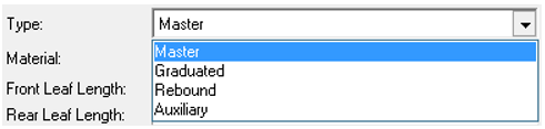

- Type
- Defines the type of a leaf.
- Master: The top leaf in the spring which has the spring eyes.
- Graduated: Remaining leaves are called as Graduated leaves, with varying lengths.
- Rebound: Any leaf that appears above the master leaf and is part of the pack.
- Auxiliary: These are usually the helper leaf modeled at the bottom of the pack, to provide additional stiffness, whenever system is at a certain jounce.
Figure 4. Available Leaf Types
