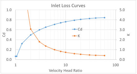

32 Inlet Head Loss Type
(K_IN_METHOD)
The type of inlet losses.
K – Incompr Loss Coef
Kin = inlet head loss / dynamic head,
or K i n = P T , s u p p l y − P T , a f t e r   l o s s 0.5   ρ   V 2 MathType@MTEF@5@5@+= feaagKart1ev2aqatCvAUfeBSjuyZL2yd9gzLbvyNv2CaerbuLwBLn hiov2DGi1BTfMBaeXatLxBI9gBaerbd9wDYLwzYbItLDharqqtubsr 4rNCHbGeaGqiVu0Je9sqqrpepC0xbbL8F4rqqrFfpeea0xe9Lq=Jc9 vqaqpepm0xbba9pwe9Q8fs0=yqaqpepae9pg0FirpepeKkFr0xfr=x fr=xb9adbiqaaeGaciGaaiaabeqaamaabaabaaGcbaaeaaaaaaaaa8 qacaWGlbWdamaaBaaaleaapeGaamyAaiaad6gaa8aabeaak8qacqGH 9aqpdaWcaaWdaeaapeGaamiua8aadaWgaaWcbaWdbiaadsfacaGGSa Gaam4CaiaadwhacaWGWbGaamiCaiaadYgacaWG5baapaqabaGcpeGa eyOeI0Iaamiua8aadaWgaaWcbaWdbiaadsfacaGGSaGaamyyaiaadA gacaWG0bGaamyzaiaadkhacaGGGcGaamiBaiaad+gacaWGZbGaam4C aaWdaeqaaaGcbaWdbiaaicdacaGGUaGaaGynaiaacckacqaHbpGCca GGGcGaamOva8aadaahaaWcbeqaa8qacaaIYaaaaaaaaaa@5889@
1) Cd – Compr Loss Coef
K i n = ( 1.0 C d ) 2 − 1.0 MathType@MTEF@5@5@+= feaagKart1ev2aqatCvAUfeBSjuyZL2yd9gzLbvyNv2CaerbuLwBLn hiov2DGi1BTfMBaeXatLxBI9gBaerbd9wDYLwzYbItLDharqqtubsr 4rNCHbGeaGqiVu0Je9sqqrpepC0xbbL8F4rqqrFfpeea0xe9Lq=Jc9 vqaqpepm0xbba9pwe9Q8fs0=yqaqpepae9pg0FirpepeKkFr0xfr=x fr=xb9adbiqaaeGaciGaaiaabeqaamaabaabaaGcbaaeaaaaaaaaa8 qacaWGlbWdamaaBaaaleaapeGaamyAaiaad6gaa8aabeaak8qacqGH 9aqpdaqadaWdaeaapeWaaSaaa8aabaWdbiaaigdacaGGUaGaaGimaa WdaeaapeGaam4qaiaadsgaaaaacaGLOaGaayzkaaWdamaaCaaaleqa baWdbiaaikdaaaGccqGHsislcaaIXaGaaiOlaiaaicdaaaa@4438@
2) Upstream Cross Flow
The inlet loss is assumed to be due to a cross flow velocity at the inlet and is calculated according to Ref. 3.
The data used is for a tube with L/D > 2.83, where the flow has recovered from the inlet effects and is at right angles to the cross flow.
The method is valid for both upstream momentum and upstream inertial chambers. It is not valid for upstream plenum chambers.

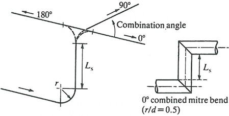

36 Bend Input Mode
(BEND_INPUT_MODE)
Flag indicating how the locations of bends are defined.
0: Bend location is distance from start of the AT in inches.
1: Bend location is defined by the distance of straight AT length between the end of the previous bend (or inlet, if it is the first bend) and the beginning of the current bend

A1 Bend Radius
(BEND_RADIUS)
(array of 20 values in 4 lines of 5 each, NUM_BENDS values used)
Radius (in) of bend along AT centerline.
(See ‘ r ’ from graphic for COMBINATION_ANGLE below)
Each bend counted in NUM_BENDS must have a specified bend radius. Enter bends in order based on distance from beginning of AT (DIST_FR_STRT).
A2 Bend Angle
(BEND_ANGLE)
Angle (deg) between the entering and exiting lengths of the bend.
Each bend must have a specified angle.
The maximum bend angle is 180°.
A3 Distance from Start
(DISTANCE)
Array of values that indicate bend location in the AT. The interpretation of the values in the array depends on the value of BEND_INPUT_MODE:
BEND_INPUT_MODE = 0: DISTANCE is cumulative straight AT segment length (in.) to the start of the current bend,
BEND_INPUT_MODE = 1: DISTANCE is straight segment length (in.) from end of the previous bend (or inlet if it is the first bend in the AT) to the start of the current bend.
A4 Loss Multiplier
(LOSS_MULT)
Loss multiplier for each bend (Default = 1.0).
A5 Combination Angle
(COMBINATION_ANGLE)
(array of 20 values in 4 lines of 5 each, NUM_BENDS minus one values used)
Relative angle (deg) between two bends in series.
The number of COMBINATION_ANGLE entries will be NUM_BENDS – 1. The first entry will be the combination angle between bends 1 and 2.
A COMBINATION_ANGLE of 0 degrees defines an ‘S’ shaped bend and 180 degrees defines a ‘U’ shaped bend.
Figure 2. Notation for combination of two 90° bends (Ref 5, pg. 228)
The allowable range is 0 to 180 degrees.

Inlet Head Loss
Having calculated (or guessed) a Mach number just inside the element inlet, inlet head loss computations are made to determine the total pressure, P t i MathType@MTEF@5@5@+= feaagKart1ev2aqatCvAUfeBSjuyZL2yd9gzLbvyNv2CaerbuLwBLn hiov2DGi1BTfMBaeXatLxBI9gBaerbd9wDYLwzYbItLDharqqtubsr 4rNCHbGeaGqiVu0Je9sqqrpepC0xbbL8F4rqqrFfpeea0xe9Lq=Jc9 vqaqpepm0xbba9pwe9Q8fs0=yqaqpepae9pg0FirpepeKkFr0xfr=x fr=xb9adbiqaaeGaciGaaiaabeqaamaabaabaaGcbaaeaaaaaaaaa8 qacaWGqbGaamiDa8aadaWgaaWcbaWdbiaadMgaa8aabeaaaaa@392F@ , at this location. The simplest loss function is a constant K-loss input value (K) that is used in the following equation to calculate P t i MathType@MTEF@5@5@+= feaagKart1ev2aqatCvAUfeBSjuyZL2yd9gzLbvyNv2CaerbuLwBLn hiov2DGi1BTfMBaeXatLxBI9gBaerbd9wDYLwzYbItLDharqqtubsr 4rNCHbGeaGqiVu0Je9sqqrpepC0xbbL8F4rqqrFfpeea0xe9Lq=Jc9 vqaqpepm0xbba9pwe9Q8fs0=yqaqpepae9pg0FirpepeKkFr0xfr=x fr=xb9adbiqaaeGaciGaaiaabeqaamaabaabaaGcbaaeaaaaaaaaa8 qacaWGqbGaamiDa8aadaWgaaWcbaWdbiaadMgaa8aabeaaaaa@392F@ :
P t i = P t s 1 + K * q / P t i MathType@MTEF@5@5@+= feaagKart1ev2aqatCvAUfeBSjuyZL2yd9gzLbvyNv2CaerbuLwBLn hiov2DGi1BTfMBaeXatLxBI9gBaerbd9wDYLwzYbItLDharqqtubsr 4rNCHbGeaGqiVu0Je9sqqrpepC0xbbL8F4rqqrFfpeea0xe9Lq=Jc9 vqaqpepm0xbba9pwe9Q8fs0=yqaqpepae9pg0FirpepeKkFr0xfr=x fr=xb9adbiqaaeGaciGaaiaabeqaamaabaabaaGcbaaeaaaaaaaaa8 qacaWGqbGaamiDa8aadaWgaaWcbaWdbiaadMgaa8aabeaak8qacqGH 9aqpdaWcaaWdaeaapeGaamiuaiaadshapaWaaSbaaSqaa8qacaWGZb aapaqabaaakeaapeGaaGymaiabgUcaRiaadUeacaGGQaGaamyCaiaa c+cacaWGqbGaamiDa8aadaWgaaWcbaWdbiaadMgaa8aabeaaaaaaaa@4592@
q = d y n a m i c   p r e s s u r e = 1 2 * ρ * V 2 MathType@MTEF@5@5@+= feaagKart1ev2aqatCvAUfeBSjuyZL2yd9gzLbvyNv2CaerbuLwBLn hiov2DGi1BTfMBaeXatLxBI9gBaerbd9wDYLwzYbItLDharqqtubsr 4rNCHbGeaGqiVu0Je9sqqrpepC0xbbL8F4rqqrFfpeea0xe9Lq=Jc9 vqaqpepm0xbba9pwe9Q8fs0=yqaqpepae9pg0FirpepeKkFr0xfr=x fr=xb9adbiqaaeGaciGaaiaabeqaamaabaabaaGcbaaeaaaaaaaaa8 qacaWGXbGaeyypa0JaamizaiaadMhacaWGUbGaamyyaiaad2gacaWG PbGaam4yaiaacckacaWGWbGaamOCaiaadwgacaWGZbGaam4Caiaadw hacaWGYbGaamyzaiabg2da9maalaaapaqaa8qacaaIXaaapaqaa8qa caaIYaaaaiaacQcacqaHbpGCcaGGQaGaamOva8aadaahaaWcbeqaa8 qacaaIYaaaaaaa@4F2C@
P t s = u p s t r e a m   s o u r c e   p r e s s u r e   ( b e f o r e   K   l o s s ) MathType@MTEF@5@5@+= feaagKart1ev2aqatCvAUfeBSjuyZL2yd9gzLbvyNv2CaerbuLwBLn hiov2DGi1BTfMBaeXatLxBI9gBaerbd9wDYLwzYbItLDharqqtubsr 4rNCHbGeaGqiVu0Je9sqqrpepC0xbbL8F4rqqrFfpeea0xe9Lq=Jc9 vqaqpepm0xbba9pwe9Q8fs0=yqaqpepae9pg0FirpepeKkFr0xfr=x fr=xb9adbiqaaeGaciGaaiaabeqaamaabaabaaGcbaaeaaaaaaaaa8 qacaWGqbGaamiDa8aadaWgaaWcbaWdbiaadohaa8aabeaak8qacqGH 9aqpcaWG1bGaamiCaiaadohacaWG0bGaamOCaiaadwgacaWGHbGaam yBaiaacckacaWGZbGaam4BaiaadwhacaWGYbGaam4yaiaadwgacaGG GcGaamiCaiaadkhacaWGLbGaam4CaiaadohacaWG1bGaamOCaiaadw gacaGGGcWaaeWaa8aabaWdbiaadkgacaWGLbGaamOzaiaad+gacaWG YbGaamyzaiaacckacaWGlbGaaiiOaiaadYgacaWGVbGaam4Caiaado haaiaawIcacaGLPaaaaaa@60D4@
There is also an option to calculate an inlet K loss based on a built-in correlation based on data reported in Ref 3, Fig 8. Converting Cd from the plot to head loss using:
V e l   H e a d   R a t i o = ( P t s − P s t u b e _ i n l e t ) ( P t s − P s u p s t r e a m   c h a m b e r ) MathType@MTEF@5@5@+= feaagKart1ev2aqatCvAUfeBSjuyZL2yd9gzLbvyNv2CaerbuLwBLn hiov2DGi1BTfMBaeXatLxBI9gBaerbd9wDYLwzYbItLDharqqtubsr 4rNCHbGeaGqiVu0Je9sqqrpepC0xbbL8F4rqqrFfpeea0xe9Lq=Jc9 vqaqpepm0xbba9pwe9Q8fs0=yqaqpepae9pg0FirpepeKkFr0xfr=x fr=xb9adbiqaaeGaciGaaiaabeqaamaabaabaaGcbaaeaaaaaaaaa8 qacaWGwbGaamyzaiaadYgacaGGGcGaamisaiaadwgacaWGHbGaamiz aiaacckacaWGsbGaamyyaiaadshacaWGPbGaam4Baiabg2da9maala aapaqaa8qadaqadaWdaeaapeGaamiuaiaadshapaWaaSbaaSqaa8qa caWGZbaapaqabaGcpeGaeyOeI0IaamiuaiaadohapaWaaSbaaSqaa8 qacaWG0bGaamyDaiaadkgacaWGLbGaai4xaiaadMgacaWGUbGaamiB aiaadwgacaWG0baapaqabaaak8qacaGLOaGaayzkaaaapaqaa8qada qadaWdaeaapeGaamiuaiaadshapaWaaSbaaSqaa8qacaWGZbaapaqa baGcpeGaeyOeI0IaamiuaiaadohapaWaaSbaaSqaa8qacaWG1bGaam iCaiaadohacaWG0bGaamOCaiaadwgacaWGHbGaamyBaiaacckacaWG JbGaamiAaiaadggacaWGTbGaamOyaiaadwgacaWGYbaapaqabaaak8 qacaGLOaGaayzkaaaaaaaa@6D37@
In addition to the inlet losses, pressure losses due to bends can also be included in the AT element. There are 2 ways to model bend losses in Flow Simulator: 1) include the bend in the AT element, 2) Use a separate bend element with the AT element only accounting for the straight length. Each method has advantages and disadvantages. Option 2 may lead to more accurate results and allows for the pressures upstream and downstream of the bends to be visible in the GUI. Option 1 is faster, and accuracy is sufficient for engineering calculations. If option 1 is used, the bend K loss is calculated the same way as the bend element K loss (see the bend element for calculation details).
