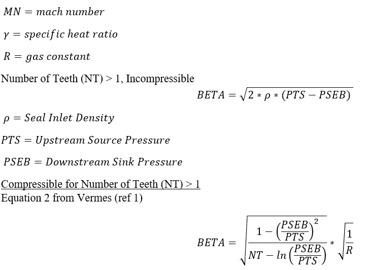

Vermes Seal Theory
Flow Rate Calculation
For a seal with one tooth, KEMULT=1.0, and BETA is calculated using the flow function. See the BETA section for details.

AREA
BETA
