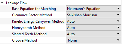

The inputs for the labyrinth TbT seal are listed below. See the image in the user interface to understand the geometric variables.

11 | BASE_EQUATION | BASE EQUATION is the user dependent choice for pressure
calculation formula in tooth by tooth marching: 0: Saikishan-Morrison Base Equation. 1: Neumann Base Equation. 2: Compressible Flow Function. The details of these base equations are provided in the Theory Section. |

16 | Clearance Factor Method (KFAC_METHOD) | 0: Bell-Bergelin curve for CD of annular orifice. 1: Bell-Bergelin Advanced, Table Lookup for multiple Re (Default). -1: User supplies their own KFAC, either constant value or calculated using controllers. See KFAC details below. |
17 | Kinetic Energy Carryover Method (KE_METHOD) | 0: Vermes 1961 Kinetic Energy Carryover curve. 1: Morrison Kinetic Energy Carryover curve. 2: Minimum of Vermes and Morrison curves (default, matches NASA Tipton data best). 3: Saikishan-Morrison. 4: Neumann Kinetic Energy Carryover curve. 5: Stepped Kinetic Energy Carryover. 6: Auto. -1: User-supplied KEMULT, either constant value or calculated using controllers. See KEMULT details below. |
Index | UIName (*.flo label) | Description |

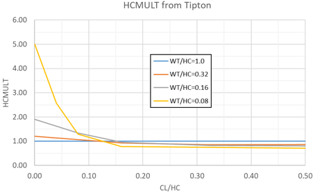

18 | Honeycomb Method (HC_METHOD) | 1: Auto, Tipton/Schramm Method (Default) – Tipton for Straight
Seals, Schramm for Stepped Seals. 2: Stocker curve for straight seals. 3: Schramm curve for stepped seals. 4: Tipton table lookup for straight seals. -1: User-supplied HCMULT, either constant value or calculated using controllers. See HCMULT details below. |
19 | Slanted Teeth Method (SL_METHOD) | 1:Curve fitted to NASA Tipton data. -1:User supplies their own SLMULT, either constant value or calculated using controllers. See SLMULT details below. 2: Auto. 3: Stepped slanted tooth factor. |
20 | Honeycomb Size (HCSIZE) | Honeycomb Size – Standard choices are 1/32”, 1/16”, and 1/8”. However, it is possible to input a custom honeycomb size. Solver units are inches. |

23 | Honeycomb Flow Multiplier (HCMULT) | Honeycomb Flow Knockdown Factor is a multiplier that is applied to non-honeycomb leakage flow to calculate the corrected leakage flow with a honeycomb stator. Typical values are from 0.8 to 1.2. Values less than one imply the honeycomb is supplying an additional source of resistance, which is often true for straight seals. Values greater than one imply that the honeycomb is creating a new path for leakage flow, which is often true for stepped seals. Please see Stocker and Schramm for additional details. |

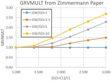

37 | Groove Depth (GRV_DEPTH) | Depth of the groove (GD) in the honeycomb (or other land material). |
38 | Groove Width (GRV_WIDTH) | Width of the groove (GW) in the honeycomb (or other land material). |
39 | Groove Tooth Axial Position (GRV_AX) | Location of the tooth in the groove. 0 = tooth in the center of
the groove. -1 = tooth hitting left edge of groove1 = tooth hitting right edge of groove. Not used in built-in methods yet but can be useful for controller or custom groove loss correlations. |
40 | Groove Multiplier (GRV_MULT) | Groove Flow Knockdown Factor is a multiplier that is applied to a no-groove leakage flow to calculate the leakage flow with a groove. Can be greater or less than 1. If the tooth is outside the groove, GRV_MULT should be > 1 indicating more flow through the seal. |
41 | Groove Method (GRV_METHOD) | Method to use to calculate the groove effect. -1= User Specified GRV_MULT 1 = Zimmerman Method. |

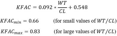

- KFAC
- KFAC, or clearance factor, is equivalent to the Vermes K variable that
accounts for the effect of the ratio of seal tooth tip width to the seal
clearance. There are five options:
- 0. Bell-Bergelin (Ref 3)The value used approximates the data shown in Figure 2 of the Vermes paper (also from Bell-Bergelin, ref. 3) and is given by the equation:

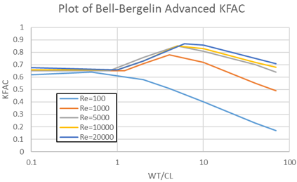

- 1. Bell-Bergelin Advanced. Uses a table of KFAC vs WT/CL for
several Reynolds numbers from Ref. 3. Bilinear interpolation
used to find KFAC. The Bell-Bergelin equation shown above
matches the Re = 10,000 curve. The Advanced option is more
accurate for Re < 10,000. Re is the annular orifice (tooth
gap) Reynolds number and can be found in the
*.res file.
Figure 4.
- 2. Saikishan Morrison KFAC
It uses the Clearance factor from the Saikishan Morrison paper (Ref 2). The factor described as the CD for first tooth is treated as KFAC here. Since the Saikishan Morrison formulation corresponds to straight and smooth seals, the CD for the first tooth has only two components, KEMULT and KFAC. KEMULT = 1.0 for the first tooth. As per Saikishan Morrison, the KFAC is written as:
For the first tooth,
For subsequent teeth,

- HCMULT
- The honeycomb flow multiplier has five options.
- Auto.The Auto method uses the recommended Tipton Straight HC curve for straight teeth pockets, and the Schramm Stepped for stepped teeth pockets. This is the default.Note: For the first tooth of a stepped seal, there is no pocket upstream, hence the Auto method applies the recommended straight correlation for the first tooth.
- Schramm Stepped Seal (Ref 4, Fig 12).
- Stocker Straight (Ref 4, Fig 12).
- Tipton Straight (Ref 7, Fig 26).An HCMULT is calculated using a bilinear interpolation of the curves shown here.
Figure 5.
- User Specified.
- Auto.
- GVRMULT
- The flow knockdown factor due to a groove in the honeycomb.
Choked Flow Calculation
For compressible gases, the calculated seal mass flow is compared to the mass flow for choked flow through the last tooth. If the choked flow through the last tooth is less than the calculated seal mass flow, the choked flow is used. The equations for the choked flow calculation are:
Where,
This accounts for the additional flow area if the honeycomb cell allows the seal to flow more than a smooth surface (HCMULT > 1 if clearance is small and HC size is large).

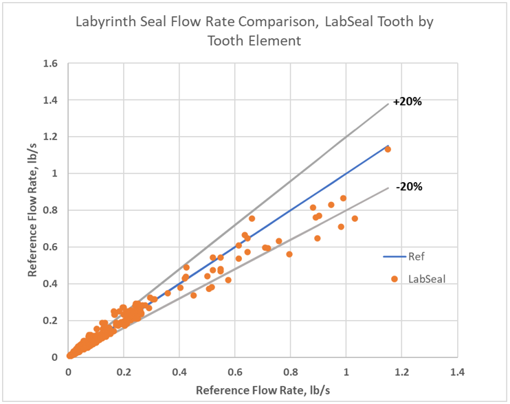

Labyrinth Seal TbT Validation
The labyrinth seal tooth by tooth results were compared to results from Tipton et al. (ref 7).
There are 705 labyrinth seal cases with a wide range of geometries and operating conditions.
- Geometries
- Number of teeth: 1, 3, 4, 5, 6, 10, 18
Step Height(in): -0.12, 0, +0.12
Honeycomb (in): Solid, 1/32, 1/16, 1/8
Tooth Slant Angle (deg): 0, 20, 40, 42.5
Tooth Wedge Angle (deg): 0, 10, 14, 15, 19
Tooth Spacing (in): 0.1, 0.177, 0.179, 0.25, 0.30, 0.354, 0.378, 0.626
Tooth Height (in): 0.1, 0.126, 0.135, 0.17, 0.25, 0.5
Tooth Tip Radius (in): 2.0, 2.26, 3.0, 3.36, 5.0, 7.63
Clearance (in): 0.004, to 0.061
- Geometry Ratios
- Pitch/Clearance: 4 to 156
Width/Clearance: 0.25 to 62.75
Width/Pitch: 0.031 to 0.67
Width/Honeycomb Size: 0.08 to 0.48
Clearance/Honeycomb Size: 0.04 to 0.65
- Operating Conditions
- Pressure Ratio: 1.04 to 6.8
Rotor Speed (RPM): 0, 13000, 20000, 30000
- Element Leakage Flow Factor Settings
Figure 11.
