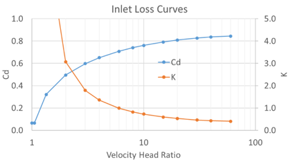

Inlet Head Loss Type: K – Incompr Loss Coef [Inlet K] Or Cd – Compr Loss Coef [Inlet Cd] Or Upstream Cross Flow (HL_FLAG) |
Specifies the method for calculating head loss at the inlet plane. Allowable values for HL_FLAG are: -20, the range of -1. to 0., and the range of all positive real numbers. HL_FLAG = 0. or any positive real number HL_FLAG will be used as the inlet head loss coefficient, K in, defined as: Kin = inlet head loss / dynamic head, or
The discharge coefficient, Cd, will be calculated from Kin by the following incompressible relation:
HL_FLAG = -1.+ to 0. HL_FLAG will be interpreted as a discharge coefficient, Cd. The inlet loss coefficient, K in will be calculated from Cd by the incompressible relation:

Having calculated (or guessed) a Mach number just inside the tube inlet, inlet head loss computations are made to determine the total pressure, Pti, at this location. The simplest loss function is a constant K-loss input value (K) that is used in the following equation to calculate Pti:
There is also an option to calculate an inlet K loss based on a built-in correlation based on data reported in Reference 2, Figure 8. Converting Cd from the plot to head loss using:
