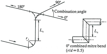

4 Number of bends
(NUM_BENDS)
Number of bends in the tube. Each bend is defined by a bend radius, bend angle, location in the tube (either distance from start of tube, or a specified straight segment length between bends), loss multiplier and combination angle.

36 Bend Input Mode
(BEND_INPUT_MODE)
Flag indicating how the locations of bends are defined.
0: Bend location is distance from start of the tube in inches.

A1 Bend Radius
(BEND_RADIUS)
(array of 20 values in 4 lines of 5 each, NUM_BENDS values used)
Radius (in) of bend along tube centerline.
(See ‘ r ’ from graphic for COMBINATION_ANGLE below)
Each bend counted in NUM_BENDS must have a specified bend radius. Enter bends in order based on distance from beginning of tube (DIST_FR_STRT).
A2 Bend Angle
(BEND_ANGLE)
Angle (deg) between the entering and exiting lengths of the bend.
Each bend must have a specified angle.
The maximum bend angle is 180°.
A3 Distance from Start
(DISTANCE)
Array of values that indicate bend location in the tube. The interpretation of the values in the array depends on the value of BEND_INPUT_MODE:
BEND_INPUT_MODE = 0: DISTANCE is cumulative straight tube segment length (in.) to the start of the current bend,
BEND_INPUT_MODE = 1: DISTANCE is straight segment length (in.) from end of the previous bend (or inlet if it is the first bend in the tube) to the start of the current bend.
A4 Loss Multiplier
(LOSS_MULT)
Loss multiplier for each bend (Default = 1.0).
A5 Combination Angle
(COMBINATION_ANGLE)
(array of 20 values in 4 lines of 5 each, NUM_BENDS minus one values used)
Relative angle (deg) between two bends in series.
The number of COMBINATION_ANGLE entries will be NUM_BENDS – 1. The first entry will be the combination angle between bends 1 and 2.
A COMBINATION_ANGLE of 0 degrees defines an ‘S’ shaped bend and 180 degrees defines a ‘U’ shaped bend.
The allowable range is 0 to 180 degrees.
Figure 2. Notation for combination of two 90° bends (Ref 16, pg. 228)
