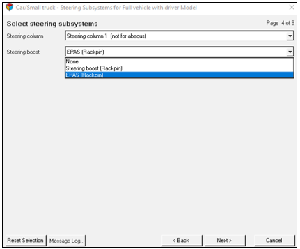

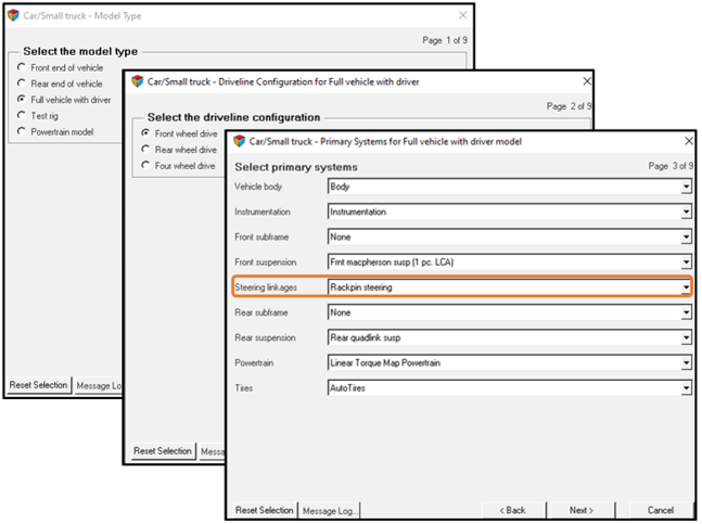

In the Model Type window, select the following:
In steering subsystems EPAS (Rackpin) will be available
as a Steering boost method.
Other options for the model systems are left to your discretion.
Completing the Assembly Wizard’s selections will lead to a full vehicle model with Altair Driver and an Electric Power Assisted Steering System.Figure 13.
