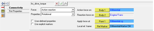

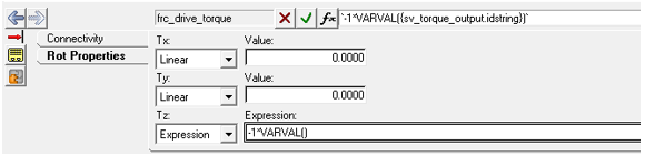

- Differential Torque or Drive Torque: Torque output of the powertrain.
Tz – Expression = ‘-1*VARVAL({Torque Output Solver Variable IDstring})’
