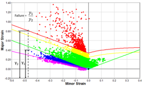

For Display, select a contour.
- Zone contour - creates a formability contour based on the deformation mode, which is derived from the ratio of major and minor strains.
- Distance contour - creates a formability contour based on the distance of each strain pair from the FLC.
- Failure contour (%) - Creates a failure contour
based on the relative distance of an element in FLC from line (Y1/Y2)*100.
See the figure below. Its value will be between 0-100 for points below the
failure line and above 100 for points above the failure line.
