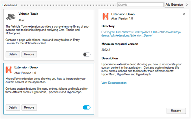

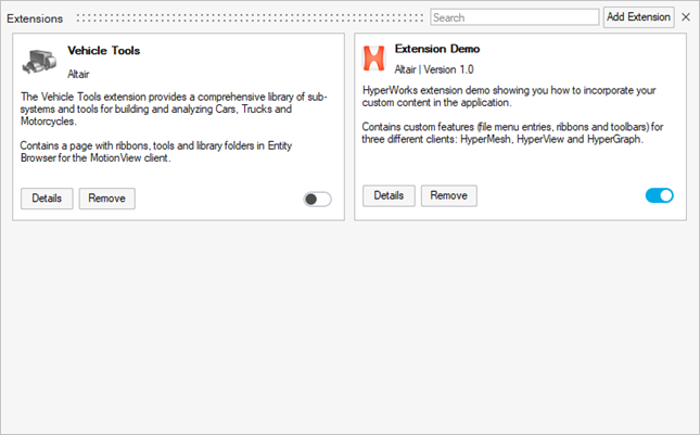

    3. To load the extension, enable the slider.
      1. Extension Manager with Loaded Extensions
  3. To unload an extension, disable the slider in the Extension Manager dialog.
  4. To unregister an extension, select the desired extension and click Remove in the Extension Manager dialog.
  5. Select the desired extension to see the Extension detailed view containing more information about the extension.
    The detailed view shows the location of the Extension and provides access to additional help in the Description area, if the extension provides it:
    2. Extension Detailed View

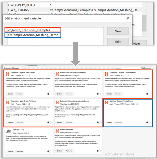

  6. オプション: To start with a pre-defined set of extensions, set the environment variable HWX_PLUGINS to add one or more directories separated by a comma.
    The Remove button for those directories is disabled.
