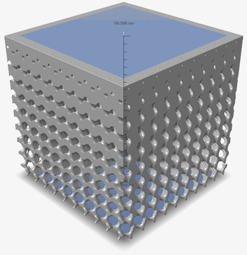

A field can be thought of as a 3D grid, and each grid point contains a signed scalar value. An illustrative example would be to create a field based on the signed distance to a plane or line, and then rescale these distances into density values. This field can then be used to control the relative density of another geometry, such as a lattice, at each location in space.

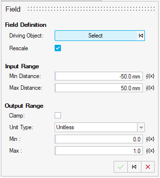

To map the distance field to a new output range, turn on
Rescale.
An illustrative example is to control the relative density of a lattice based on the signed distance values. Here, signed distance values will be rescaled into the desired relative density range. For example, if you want a relative density of 25% at zero distance to the driving geometry and a relative density of 75% at 50 mm away from the object, the inputs to the rescale will be as follows:
Min Distance: 0.0 mm
Max Distance: 50.0 mm
Min Density: 25.0
Max Density: 75.0
Define the Input Range, which can be constant or
variable driven.
- Min Value: The lowest numerical value of interest in the input field, which might come from driving geometry such as distance to an implicit body, distance to construction geometry (point, axis, and plane), or select BRep features (vertex, line segment, arc, planar surface, cylindrical surface). Please note that this is not the value that is closest to zero, it is the smallest value on a number line. For example, -25.3 is smaller than -0.1.
- Max Value: The highest numerical value of interest in the input field, which might come from driving geometry such as distance to an implicit body, distance to construction geometry (point, axis, and plane), or select BRep features (vertex, line segment, arc, planar surface, cylindrical surface). Please note that this is not the value that is closest to zero; it is the largest value on a number line. For example, -0.1 is larger than -25.3.

- Min Value: The value that the Min Value from the input field should map to in the newly created output field (e.g., a density value of 25% or a distance such as 0.0 mm).
- Max Value: The value that the Max Value value from the input field should map to in the newly created output field (e.g., a density value of 75% or a distance such as 50.0 mm).

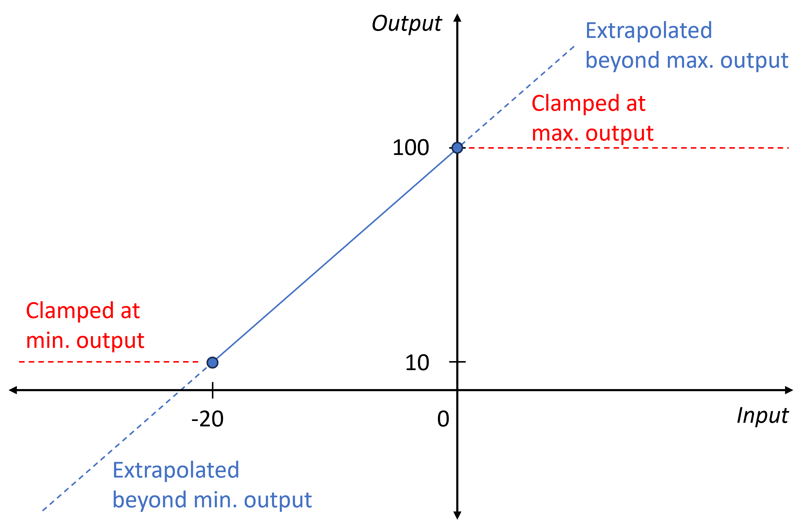

- Optional: To prevent values going below or above the Min and Max values, respectively, turn on Clamp.
