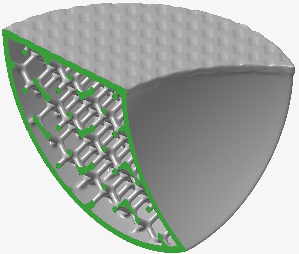

Mean Smoothing
Using a width of 1 (3 x 3 x 3 voxel kernel) and a single iteration:- Noisy artifacts removed from top face.
- The texture depth and detail have both been reduced.
- The noise along the sharper spherical edges has been reduced in a desirable manner.
- Some spherical edges that we may have wished to remain sharp have been noticeably rounded.
- The lattice struts are marginally thinner, but the junctions at the nodes and with the outer body have a noticeable fillet-like joint, which can be very useful for relieving stress raisers.

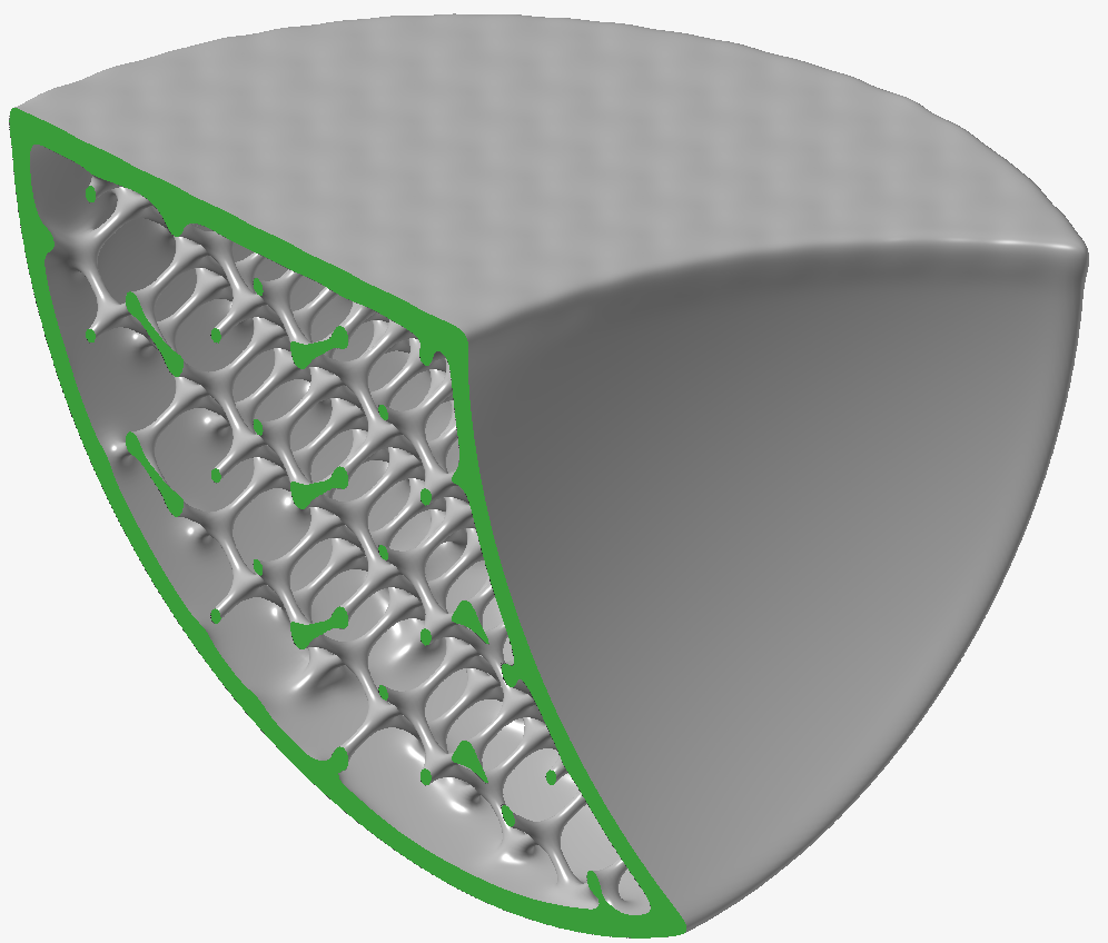

Interestingly, increasing the width of the kernel to two (5 x 5 x 5 voxel kernel) and using a single iteration is more severe than the previous example of using the same kernel with two iterations. In the image below, the struts in the lattice are thinner still, and the texture is almost completely lost.

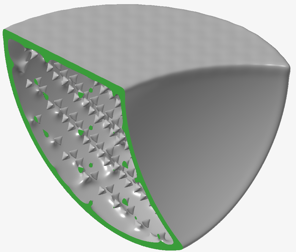

Finally, using a width of two and two iterations, the Mean smoothing starts to destroy struts in the lattice and the texture has practically disappeared.

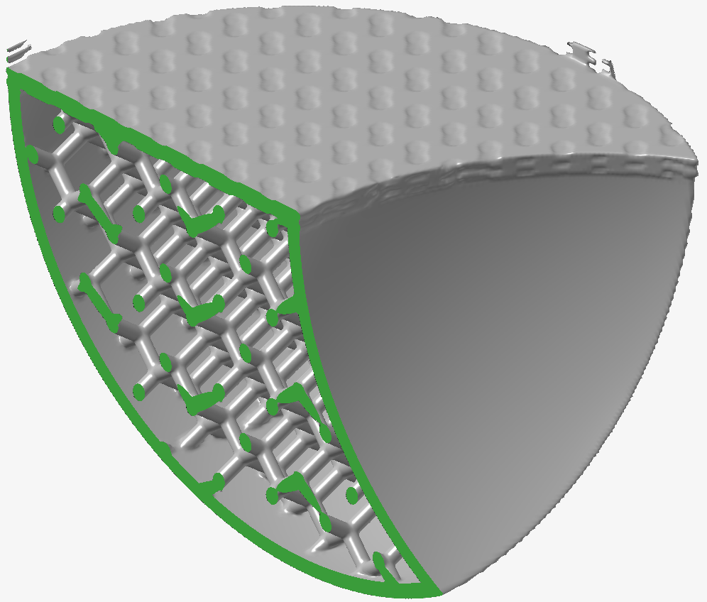

Median smoothing is quite different from the other filters in terms of mathematical and computational composition. It is the only filter that ranks the values within the kernel, before selecting the middle value. It is therefore inherently non-linear. Using a kernel width of one and a single iteration, the following results are achieved:
- Noisy artifacts removed from the top face.
- The texture depth and detail have both been preserved (more than Mean smoothing).
- Some spherical edges that we may have wished to remain sharp are sharper than with Mean smoothing.
