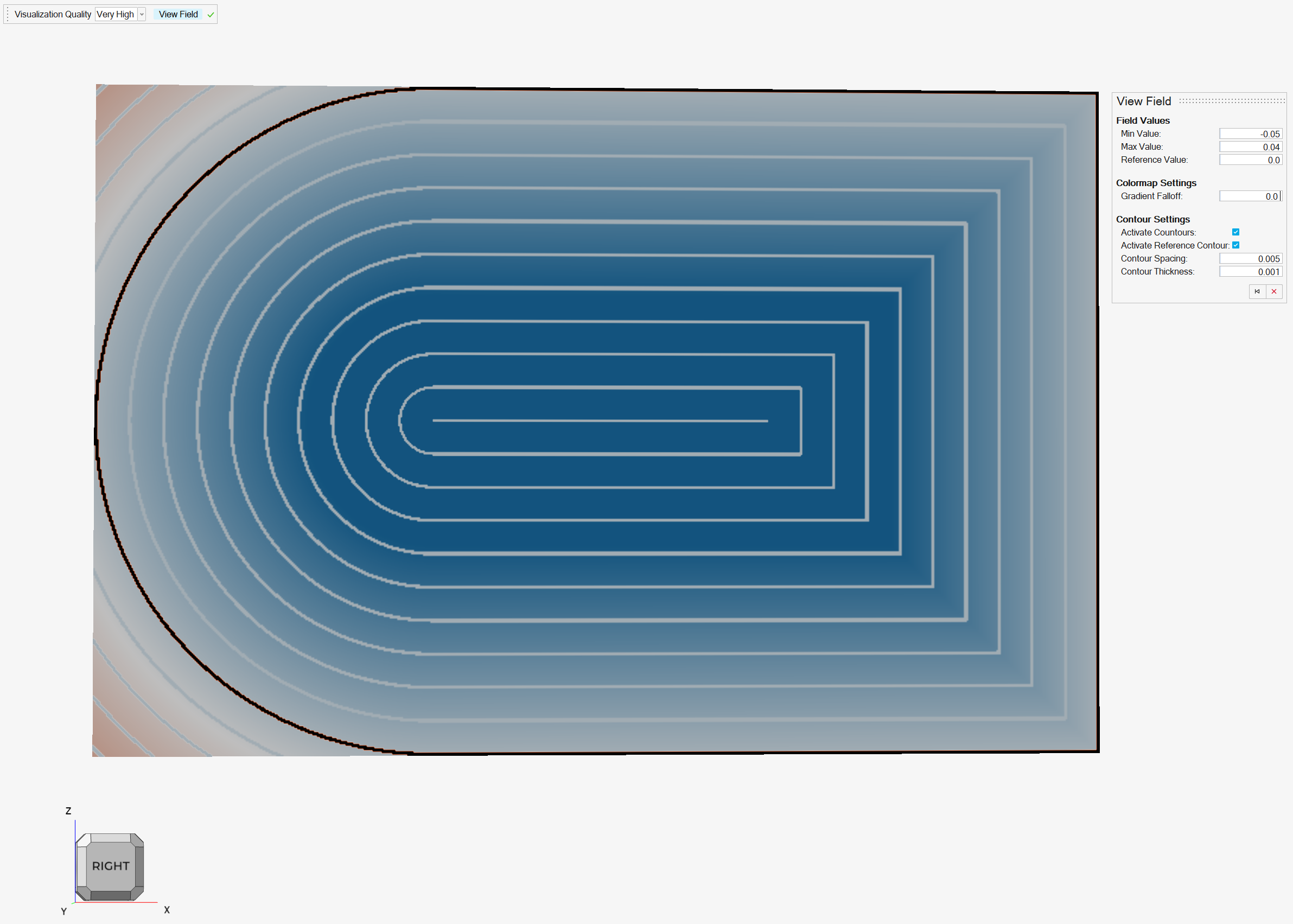

In the image above, red regions are external to the object, blue regions are internal, and black contours/surfaces are on the surface. White contours are used like a 3D ruler to show how the scalar values of the field are progressing away from the surface.

![](../../images/figures/inspire/view_field_panel.png)
The Field Values controls let us set the field values of interest that will be colored and contoured by the View Field tool. For example, we may only be interested in field values +/-10mm from the surface. This can be achieved with the following settings:
![](../../images/figures/inspire/view_field_clamped_field_values.png)
We now only have color and contours spanning the relevant field values, and the rest of the scene is blank.

The next group of settings come under the Contour Settings heading . The black contour is reserved for the Reference Value in the field that is specified by the user. The white contours represent isocontours that progress away from the reference value at a given spacing.

Once you have selected a preferred visual style, you can edit the contour thickness and spacing for any active contours. The images below show some different examples. The first image uses a large contour spacing.
![](../../images/figures/inspire/view_field_large_contour_spacing.png)
