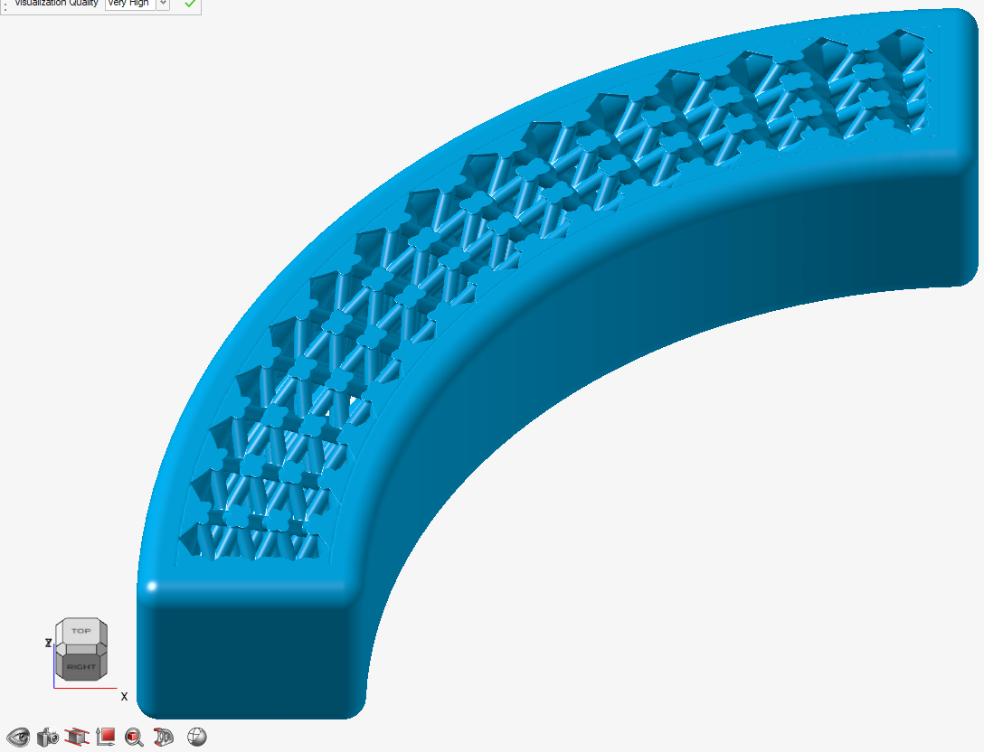

Tip: To find and open a tool, press Ctrl+F. For more information, see Find and Search for Tools. - Optional: For Visualization Quality, select from Low to Very High quality, which corresponds to a low to very high density of elements. A higher quality produces sharper geometry features but is more computationally intensive. When creating a complicated function, it’s recommended to work using a lower quality and then switch to a higher quality after the function is complete.
- Select a body to fill with strut lattice. You can select a Parasolid, STL, PolyNURBS, or implicit geometry.

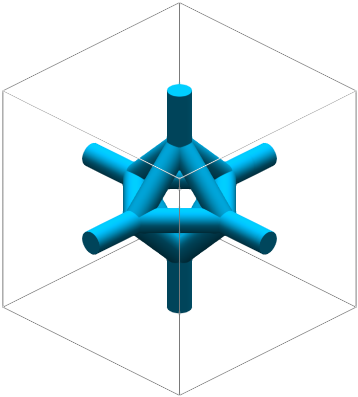

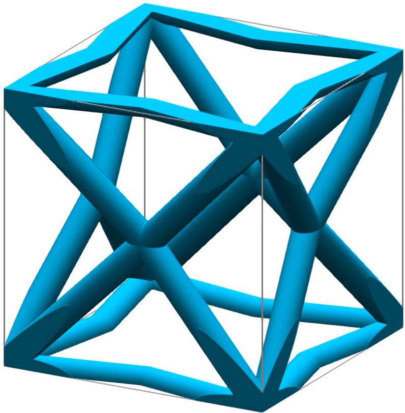

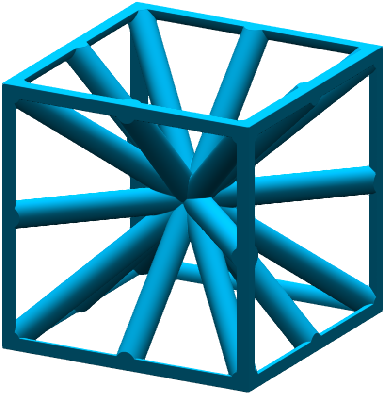

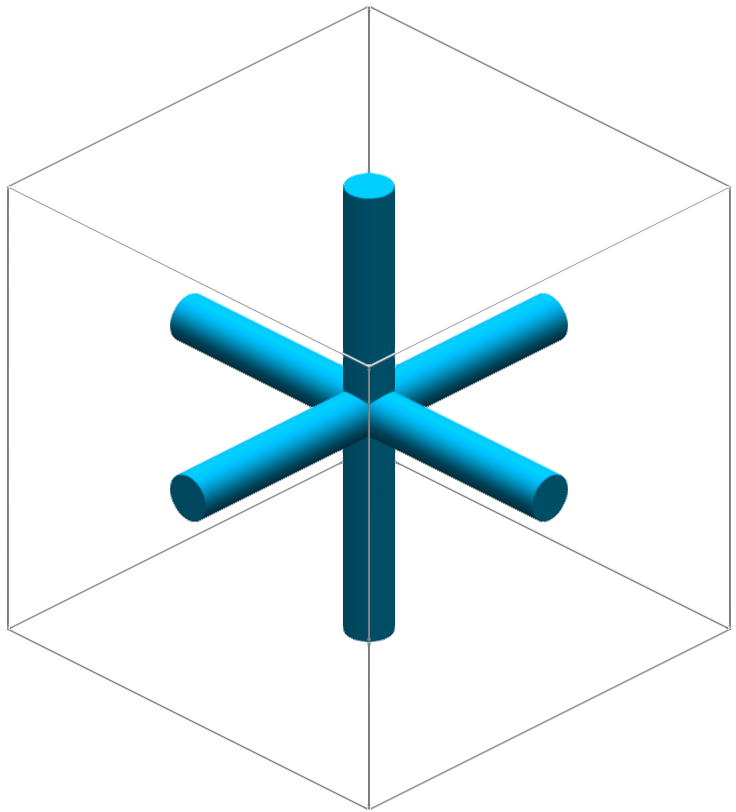

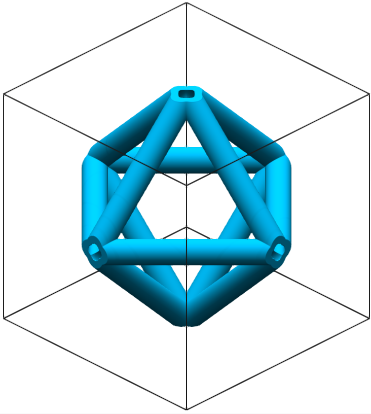

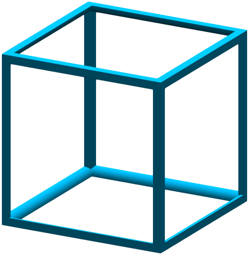

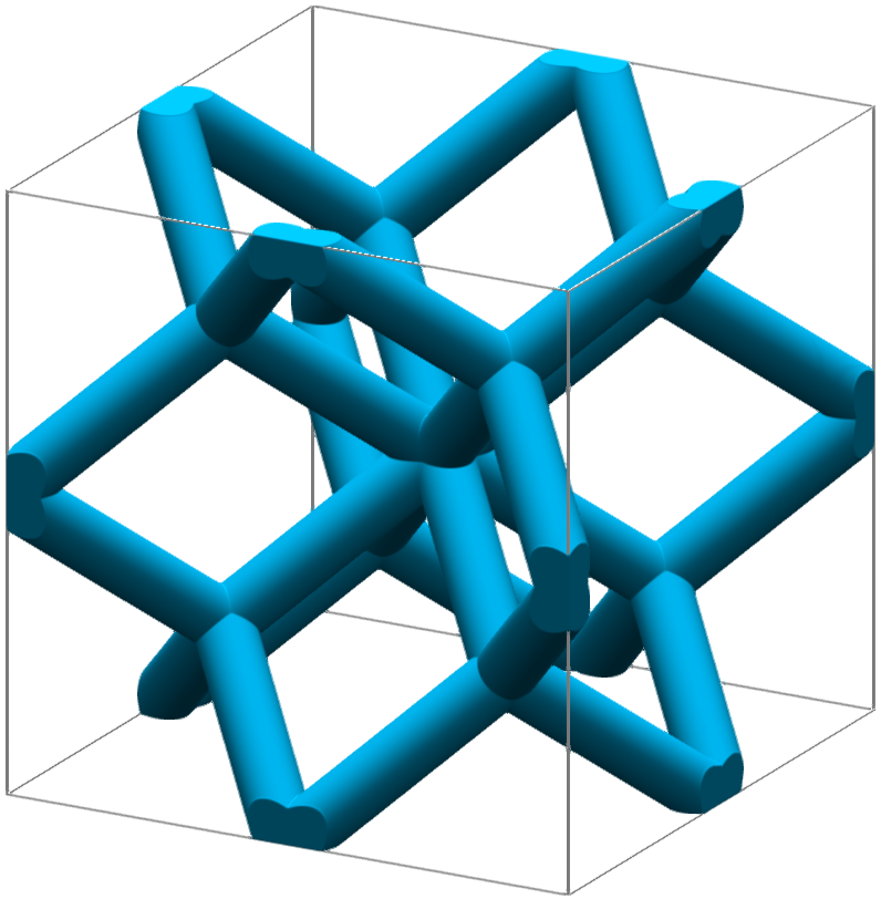

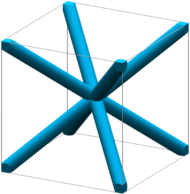

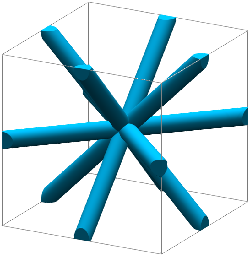

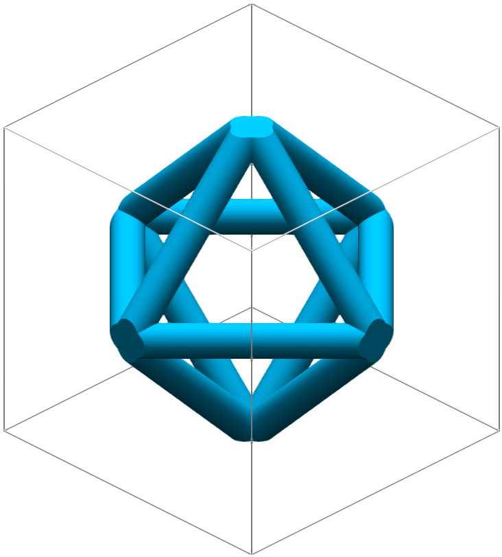

Option Description Cell - Type Select a cell type. - Body-Centered Cubic
- Face-Centered Primitive
- Face-Centered
Cubic
- Cubic Primitive
- Isotruss
- Octagon
- Hex Truss
- Kelvin Cell
- Flourite
- Diamond
- Truncated Cube
- Octet
- Create Unit Cell

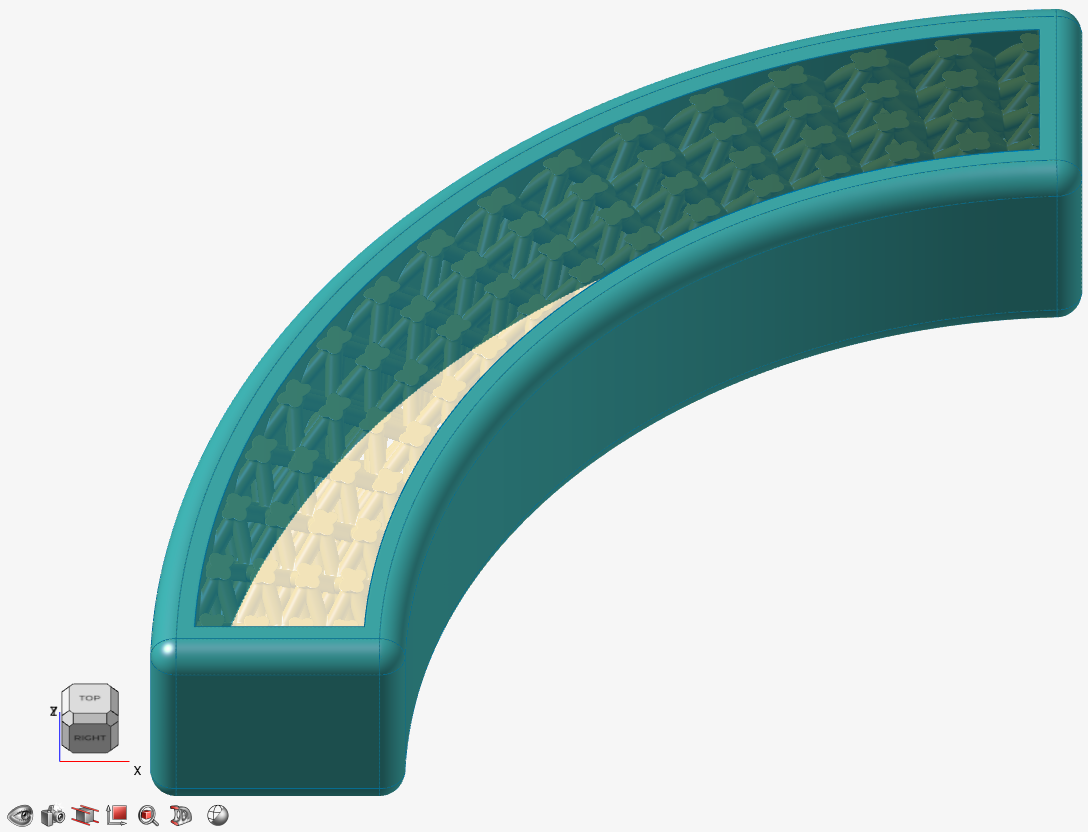

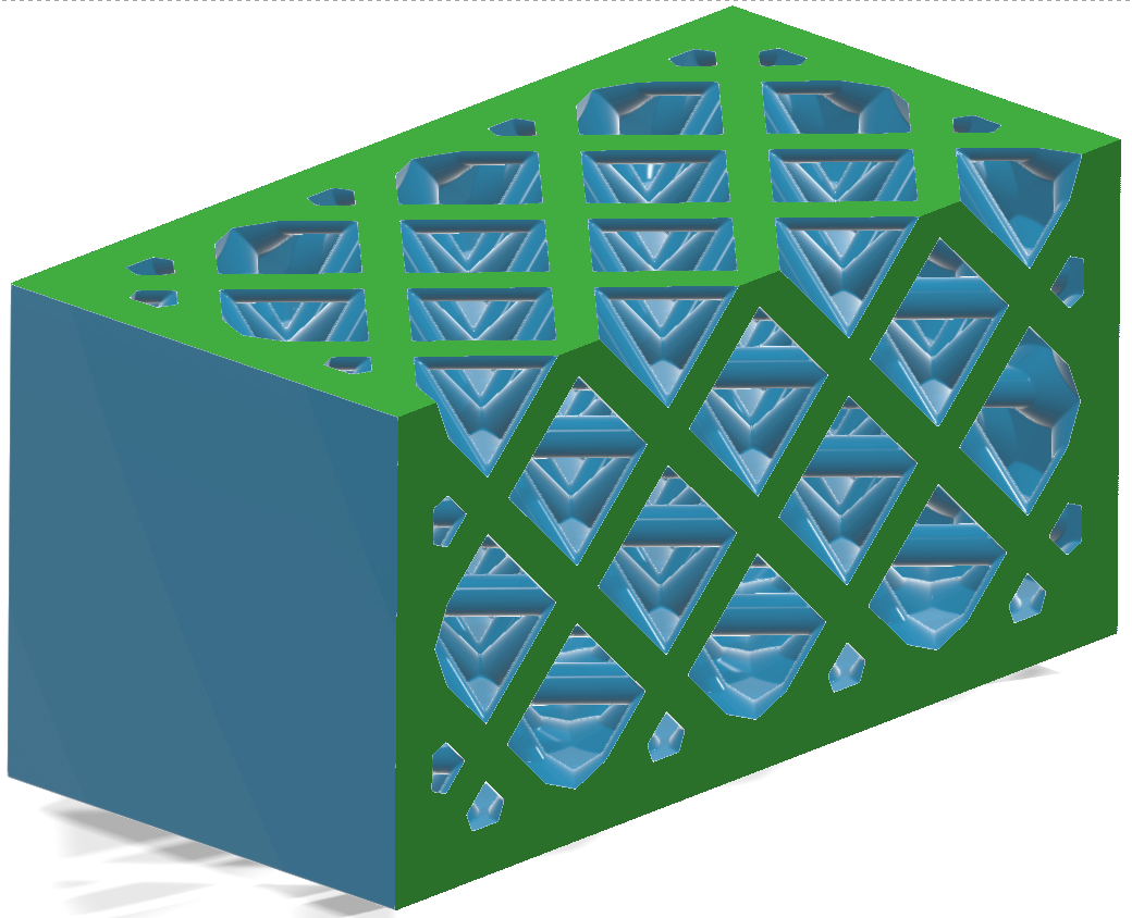

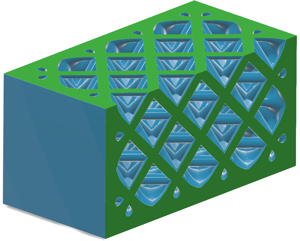

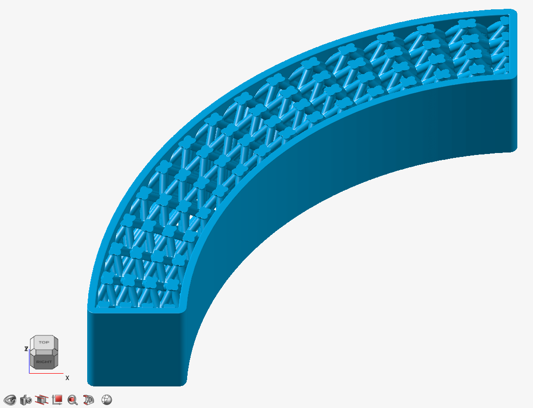

Trimming Body Select a body that's used to trim the shell. This can be used to trim areas of the shell, which is useful for fitting the lattice and its shell into a predefined volume, or when you want to expose some of the lattice so that it is not covered by a shell. In this example, a BRep body is chosen as the trimming body to expose some of the lattice. This image shows how the outward shell applied to the lattice overlaps with the trimming body.
Once the trimming is applied, some of the outward shell is cut away, exposing the lattice wherever the shell protrudes beyond the confines of the trimming body.

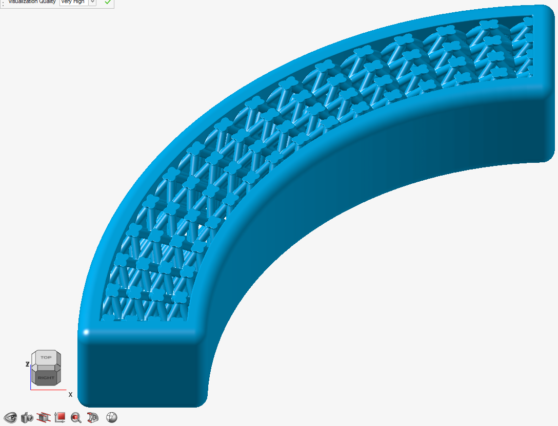

Transition Choose the type of transition between the outer body and lattice body. - Sharp: The lattice abruptly joins the surrounding shell.
- Fillet: The lattice
blends into the surrounding shell using a fillet.

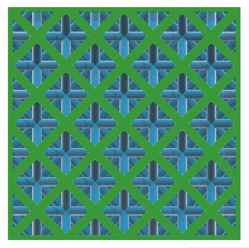

Option Description Combine Body Select a body to combine the planar lattice with. This body should be close to, or overlap with, the lattice.
abruptly joins the surrounding outer body.
blends into the outer body using a fillet. If you
selected this option, define the fillet
Radius.
- Chamfer: The lattice
blends into the outer body using a chamfer. If you
selected this option, define the chamfer
Distance.
For Fillet, the distance is the radius of the fillet and, for Chamfer, the distance is the setback of the chamfer. The distance can be entered directly, controlled with a variable, or controlled in each position in space using a field (field-driven design).
