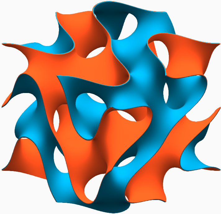

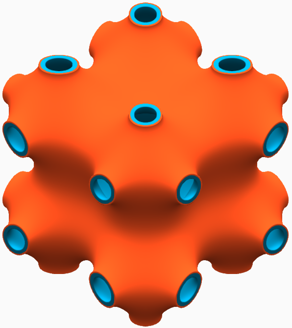

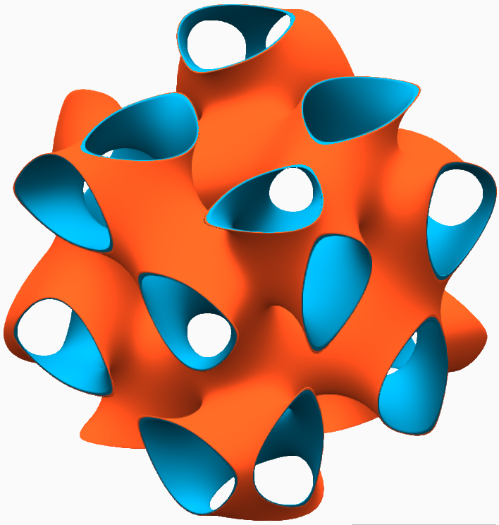

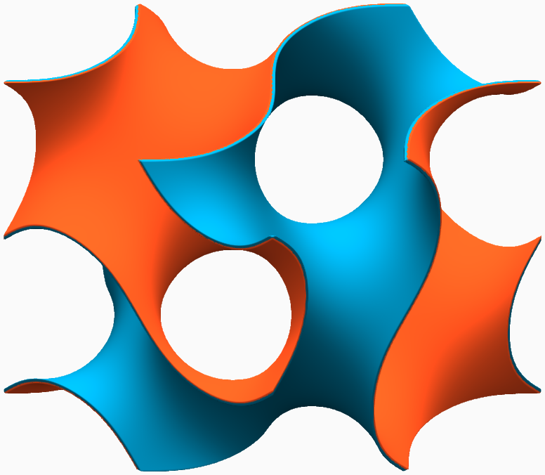

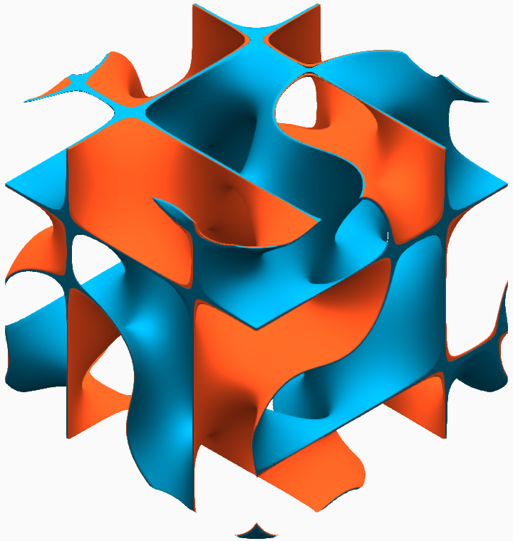

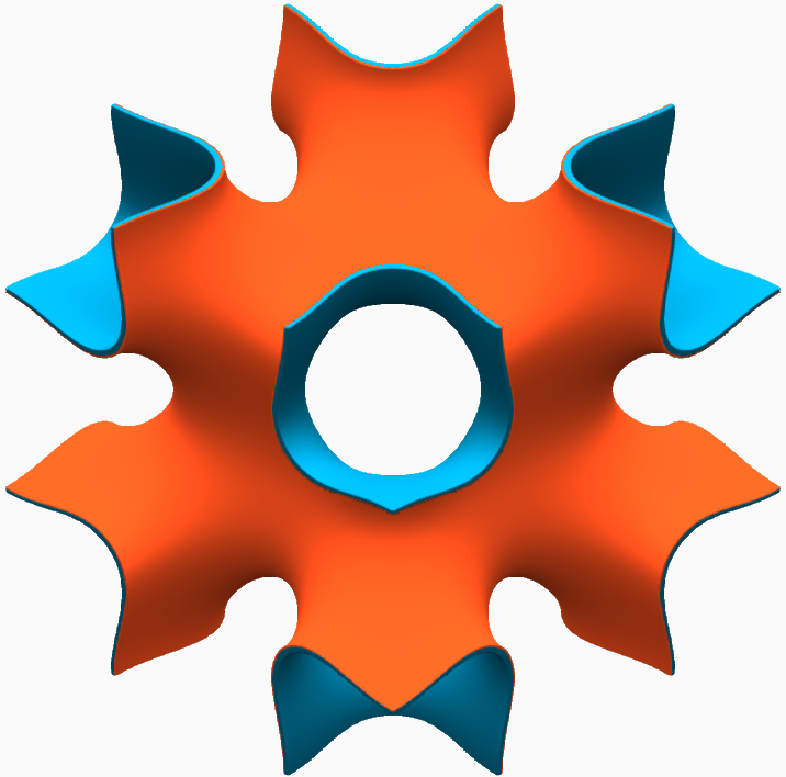

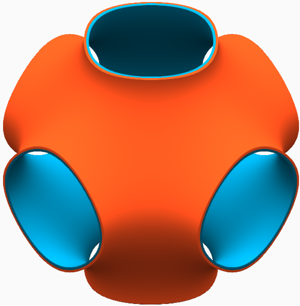

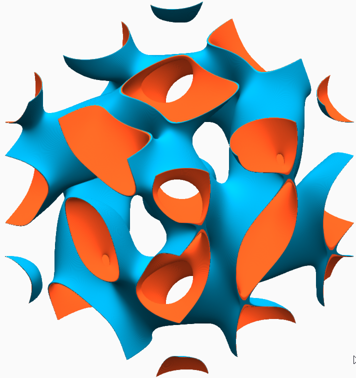

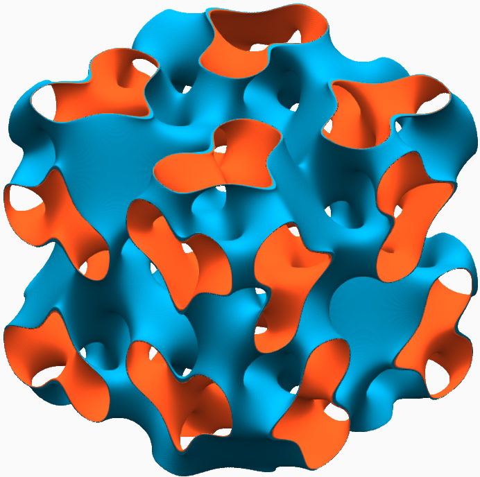

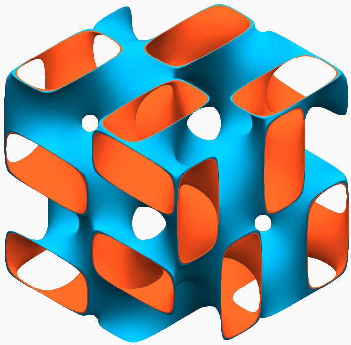

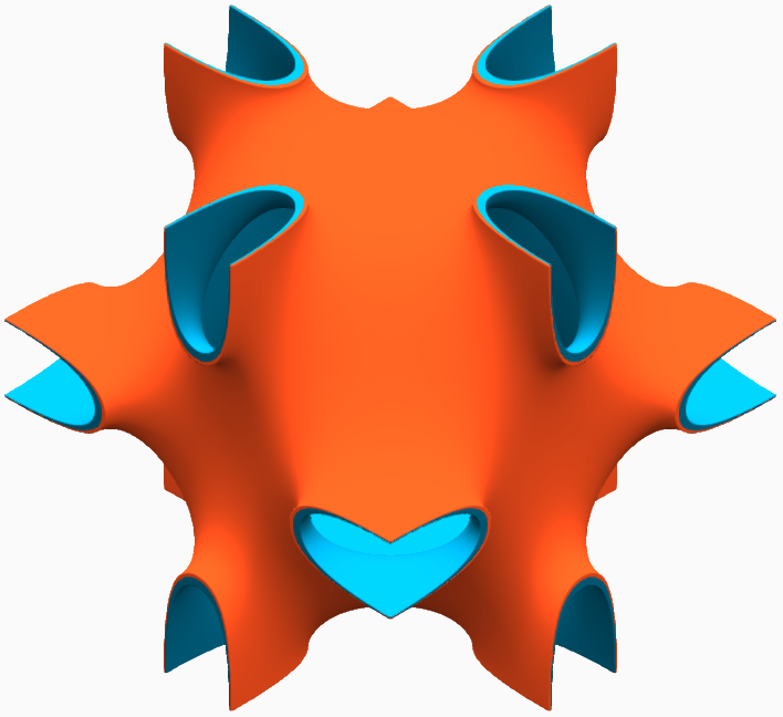

Option Description Surface - Unit Cell Select a unit cell type. In the following images, the surface that creates the lattice has been shown with blue coloring on one side of the surface and orange coloring on the other. These infinitely thin surfaces are transformed into solid volumes using the Surface Type options (Single and Double), which are described in the next section. - Gyroid
- Schwarz P
- Schwarz D
- Neovius
- Lidinoid
- Fischer Koch S
- Fischer Koch Cs
- Fischer Koch Y
- Fischer Koch Cy
- FRD
- IWP
- Split P
- Karcher K
- G Prime

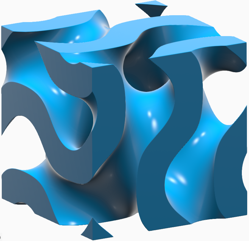

Surface - Type Select between a single or double surface lattice. - Single: Create a single, fully connected volume where one side of the surface is defined as being solid material.
- Double: Create a lattice with
two sides. In this case, two offset surfaces of the
same type are created, and the volume between the
surfaces is defined as being solid material. These
surfaces create two separate but interwoven pore
networks that are separated by the lattice volume.
This is useful for functions like heat transfer,
where you want the lattice to serve as a barrier
between two types of fluids.

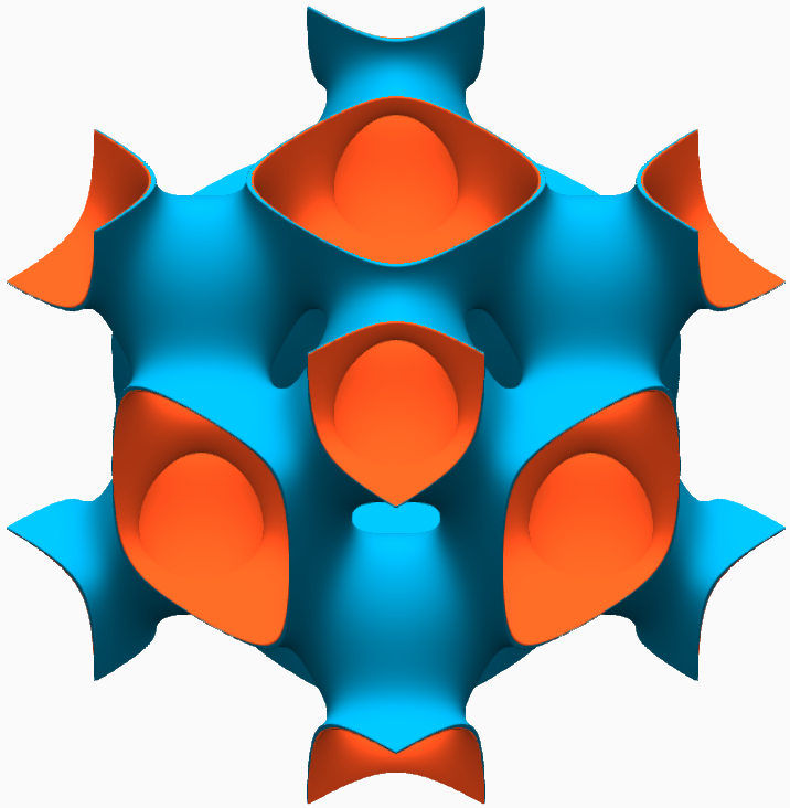

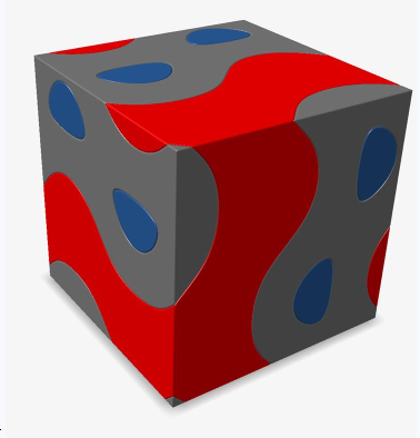

Bias When working with the Double surface lattice type, drag the slider or enter a value to vary the volumes on either side of the lattice, without changing the volume of the lattice itself. When you change the surface type to Double, there's a volume on one side of the lattice surface and a separate volume on the other side. The bias allows you to make one of those volumes smaller and the other larger, without changing the amount of volume that the lattice itself takes up.
In this image, the lattice volume is gray, the volume on one side is blue, and the volume on the other side is red.Note that blue is appreciably smaller than red, hence "bias."
This mostly applies to situations where you would have two fluids that are separated by a wall (lattice). Two-fluid heat exchangers are a good example of where this is helpful.
