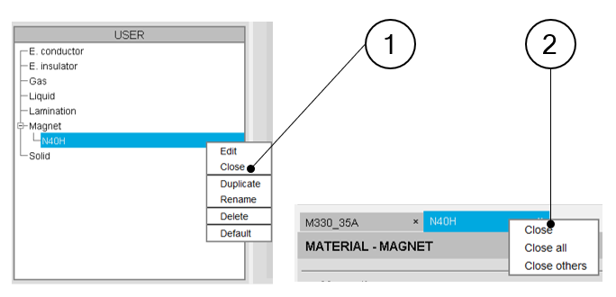

“Close a material” consists of removing the tabs of the material from the display area (output area). Several materials can be edited at the same time, therefore editing a new material does not automatically close the others.
Two ways are possible to close a material. These are shown below.
Note: The properties of the materials are hidden, but the material
still exists in the material database.
| How to hide the material properties? | |
| 1 | By selecting the material, clicking the right mouse button, and selecting the close option. |
| 2 | By selecting the material tab (above the display area), clicking the right mouse button and selecting one of the proposed options: close only the selected material, close all the materials or close all the materials excepting the selected one. |

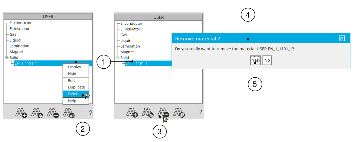

| How to delete a material? | |
| 1 | Select the name of the material to be deleted. |
| 2 | The first way to delete a material consists of using the right mouse button to expand the corresponding menu and clicking on the function Delete. |
| 3 | The second way to delete a material consists of clicking on the Delete button in the area where several functions are located at bottom part of the user material database to manage the materials. |
| 4 | A dedicated dialog box allows finalizing the deletion of the selected
material. Note: Several materials can be selected to
be deleted. |
| 5 | The deletion of the material is achieved when clicking on "Yes".
Obviously, it is possible to cancel the deletion by clicking on "No". |
