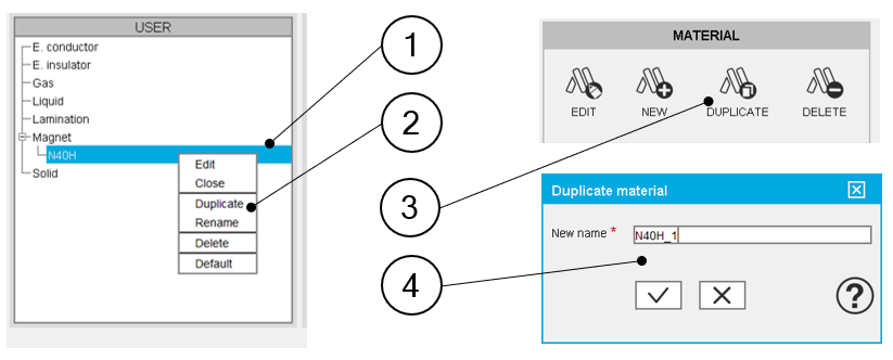

| How to duplicate a material? | |
| 1 | In any case, the material to be duplicated must be selected |
| 2 | The first way to duplicate a material consists of using the right mouse button to expand the corresponding menu and then clicking on the function Duplicate. |
| 3 | The second way to duplicate a material consists of clicking on the “Duplicate” button in the area, where several functions are located at bottom part of the user material database to manage the materials. |
| 4 | Select the new name of the new material in the dedicated dialog box and accept the duplication. |
