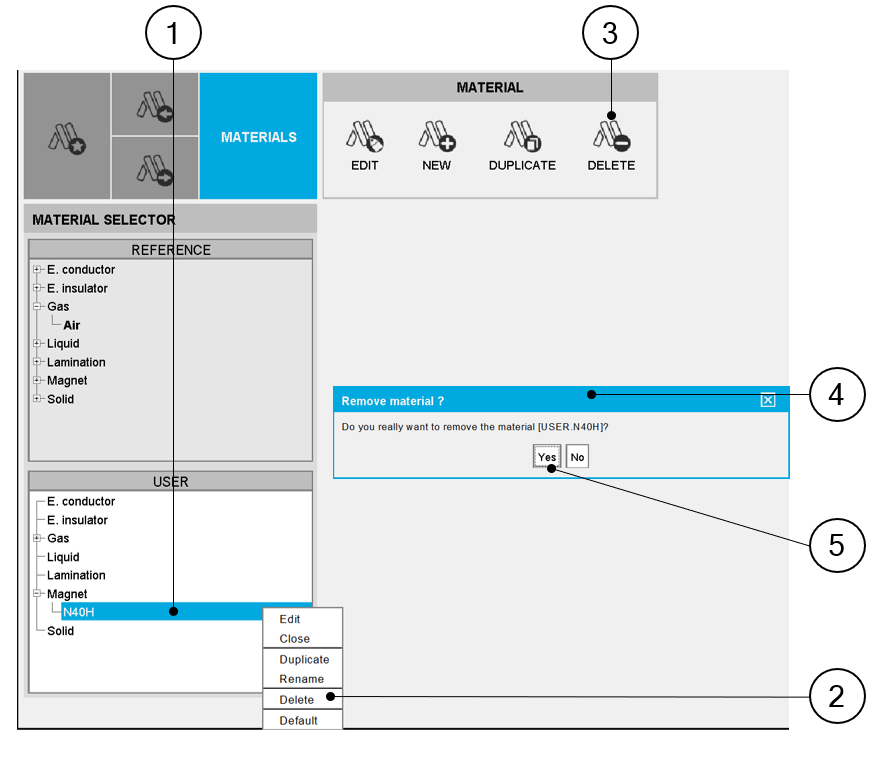

| How to delete a material? | |
| 1 | Select the name of the material to be deleted. |
| 2 | The first way to delete a material consists of using the right mouse button to expand the corresponding menu and clicking on the function “Delete”. |
| 3 | The second way to delete a material consists of clicking on the “Delete” button in the area where several functions are located at bottom part of the user material database to manage the materials. |
| 4 |
A dedicated dialog box allows finalizing the deletion of the selected
material.
Note: Several materials can be
selected to be deleted. |
| 5 |
The deletion of the material is achieved when clicking on “Yes”. Obviously, it is possible to cancel the deletion by clicking on “No”. |
