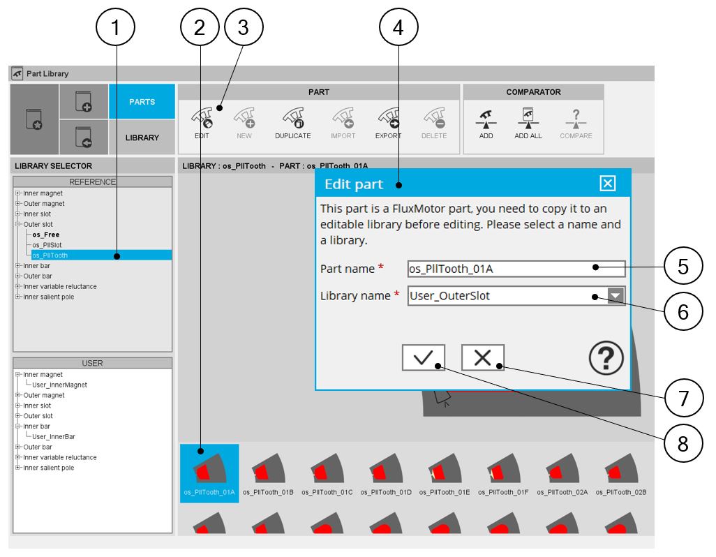

Edit part allows modifying the part geometrical properties by using the functions of Part Factory.
As all the parts from reference libraries are in Read only mode, before editing a part the user must copy it in a User’s library. A dedicated dialog box allows doing that quickly as it is shown below.
| Edit a part from reference libraries | |
| 1 | Selection of a reference library. |
| 2 | Selection of one part in the selected library. This part is displayed in the central area. |
| 3 | Click on the button “EDIT”. |
| 4 | As a part from reference library is considered, a dialog box opens which allows copying the selected part in a user’s library. |
| 5 | Give a name to the part. |
| 6 | Choose a user’s library in which the copied part will be stored. |
| 7 | Button to cancel the edited data of the part. |
| 8 | Button to apply inputs and edit the selected part. Then, Part Factory is launched allowing the reading and/or the modification of the geometrical properties of the part. |
