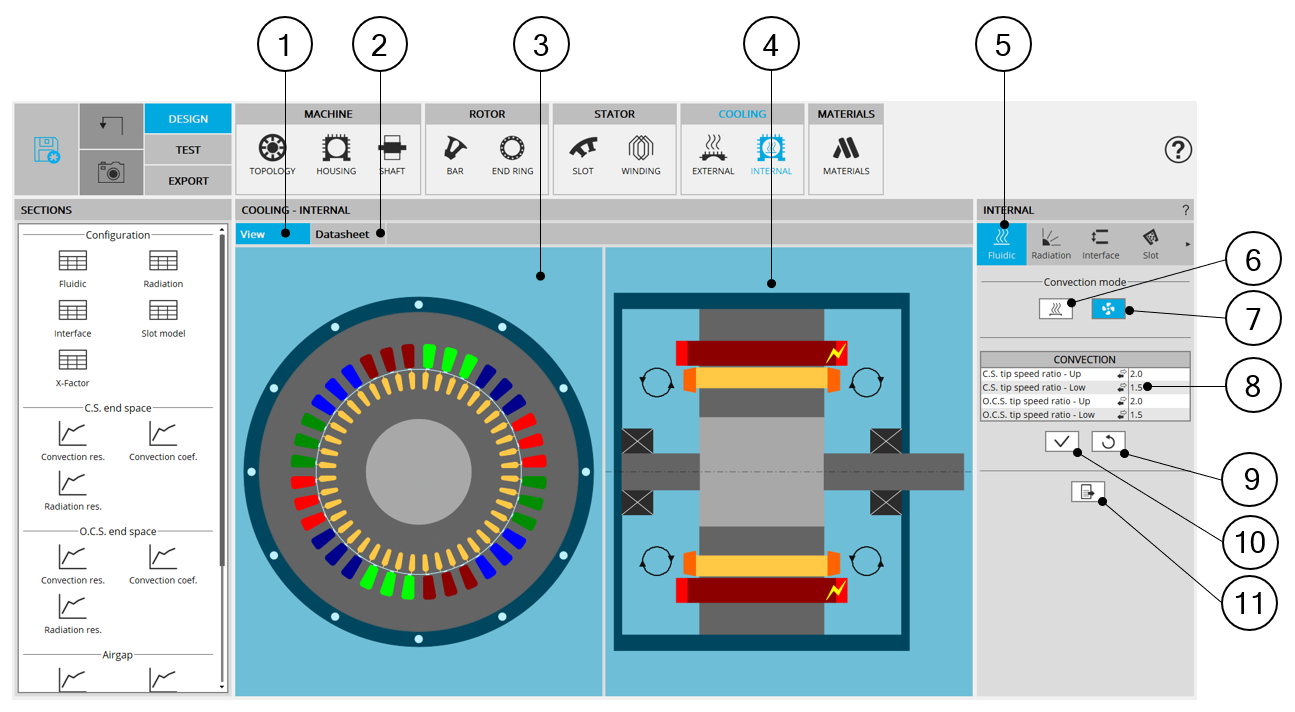

| Internal cooling - Fluidic design area | |
| 1 | Display the axial and radial view of the machine. |
| 2 | Display the internal cooling datasheet, showing the thermal parameters defining the internal heat exchanges. |
| 3 | Radial view of the motor, where specific exchange areas can be highlighted depending of the selected input. |
| 4 | Axial view of the motor, where specific exchange areas can be highlighted depending of the selected input. |
| 5 | The section “Fluidic” is selected. |
| 6 | Selected button to set that natural convection occurs in the end spaces (no specific fluid flow modeled in addition to the rotation of the machine). |
| 7 | Selected button to set that forced convection occurs in the end spaces (a specific fluid flow on each area of the end caps can be specify by the user, that can be linked to the machine rotation speed or not). |
| 8 | Input related to the fluidic corresponding to the selected convection mode. |
| 9 | Button to restore default input values. |
| 10 | Button to apply inputs. Pressing the enter key twice applies inputs too. |
| 11 | Icon to export internal cooling data into *.txt or *.xls files. |

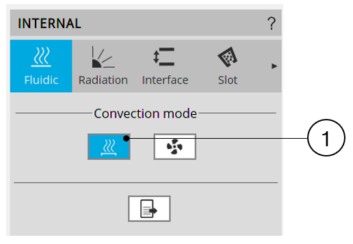

| Natural convection - Inputs | |
| 1 | Natural convection mode is selected. In this mode, there is no input to define. |

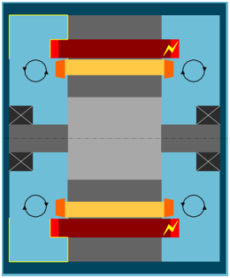

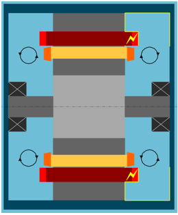

The end spaces are divided in four areas, corresponding to four inputs the user must defined in forced convection mode:

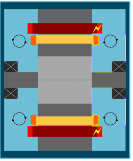

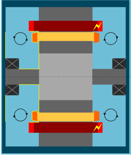

The « Upper » Connection Side region, corresponding to the Connection Side convection areas far from the rotating parts.
The « Lower » Connection Side region, corresponding to the Connection Side convection areas close to the rotating parts.
The « Upper » Opposite Connection Side region, corresponding to the Opposite Connection Side convection areas far from the rotating parts.
The « Lower » Opposite Connection Side region, corresponding to the Opposite Connection Side convection areas close to the rotating parts.
When selecting one of these four inputs, the corresponding exchange areas are highlighted in the axial view of the machine.
See below illustrations.
| Opposite Connection Side “Upper” region – far from the rotor | Connection Side “Upper” region – far from the rotor |
| Opposite Connection Side “Lower” region – close to the rotor | Connection Side “Lower” region – close to the rotor |

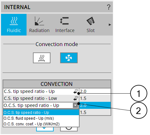

The user can select the inputs mode of each region using the dedicated arrow or clicking on the input mode to change.
| Forced convection – Selection of input modes | |
| 1 | Click on the arrow, or directly on the input mode, to show the drop-down menu allowing the input mode selection |
| 2 | Drop down menu allows choosing an input mode for the dedicated convection region. |

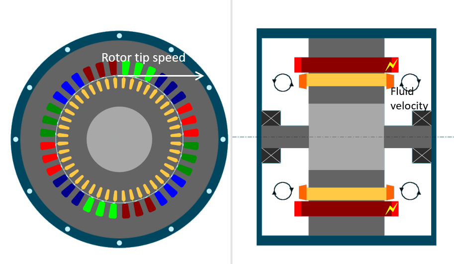

The « Tip speed ratio » input mode allows setting a fluid velocity proportional to the rotor tip speed.
| Definition of the fluid velocity proportional to the rotor tip speed |
This can be used to model a shaft mounted fan, of rotor fins.
The default values of tip speed ratios are 2 for the regions far from the rotor.
A tip speed ratio of 2 for an « Upper » region (meaning a region far from the rotor) corresponds to a shaft mounted fan, or rotor fins, that blows air to this region with an average efficiency.
For « Upper » region of a side without fan or fins, it is advised to set a rotor tip speed ratio of 5. This corresponds to the FluxMotor natural convection model.
The default value of tip speed ratio is of 1.5 for the regions close to the rotor.
In fact, for these regions, the considered fluid speed is the relative speed between the fluid velocity and the rotating parts speed, meaning that in these regions the convection is highly related to the rotation speed.

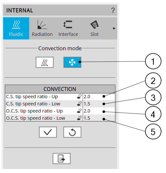

| Forced convection - Inputs | |
| 1 | Forced convection mode is selected |
| 2 | Input related to the Connection Side “Upper” region, here set as a tip speed ratio |
| 3 | Input related to the Connection Side “Lower” region, here set as a tip speed ratio |
| 4 | Input related to the Opposite Connection Side “Upper” region, here set as a tip speed ratio |
| 5 | Input related to the Opposite Connection Side “Lower” region, here set as a tip speed ratio |
