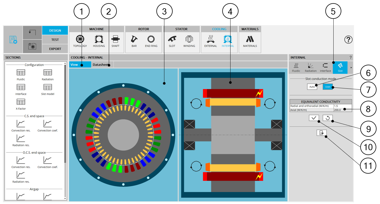

| Internal cooling – slot model design area | |
| 1 | Display the axial and radial view of the machine. |
| 2 | Display the internal cooling datasheet, showing the thermal parameters defining the internal heat exchanges. |
| 3 | Radial view of the motor, where specific exchange areas can be highlighted depending of the selected input. |
| 4 | Axial view of the motor, where specific exchange areas can be highlighted depending of the selected input. |
| 5 | The section “Slot model” is selected. |
| 6 | Button to set the slot conductivities automatically by internal process. |
| 7 | Selected button, to set the user slot conductivities. |
| 8 |
Equivalent conductivities, to be set only when the User mode has been chosen. In user mode, the following inputs must be set:
| 9 | Button to restore default input values. |
| 10 | Button to apply inputs. Pressing the enter key twice applies inputs too. |
| 11 | Icon to export internal cooling data into *.txt or *.xls files. |
