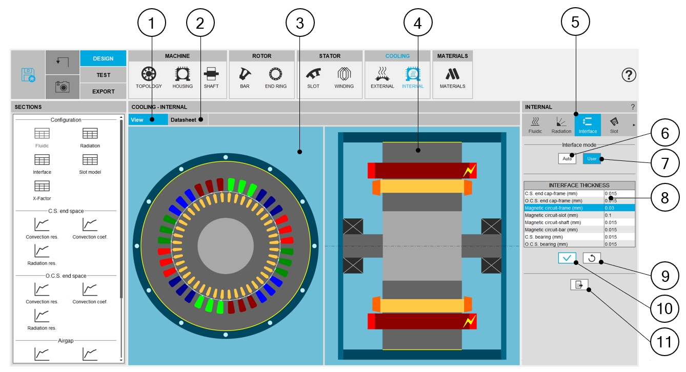

| Internal cooling - Interface design area | |
| 1 | Display the axial and radial view of the machine. |
| 2 | Display the internal cooling datasheet, showing the thermal parameters defining the internal heat exchanges. |
| 3 | Radial view of the motor, where specific exchange areas can be highlighted depending of the selected input. |
| 4 | Axial view of the motor, where specific exchange areas can be highlighted depending of the selected input. |
| 5 | The section “Interface” is selected. |
| 6 | Button to set the interface gaps automatically by internal process. |
| 7 | Selected button, to set user interface gaps. |
| 8 |
Parasitic interface thicknesses corresponding to the selected interface mode. In user mode, the following thicknesses must be set:
This corresponds to the imperfect contact between the liner and the iron core.
| 9 | Button to restore default input values. |
| 10 | Button to apply inputs. Pressing the enter key twice applies inputs too. |
| 11 | Icon to export internal cooling data into *.txt or *.xls files. |
