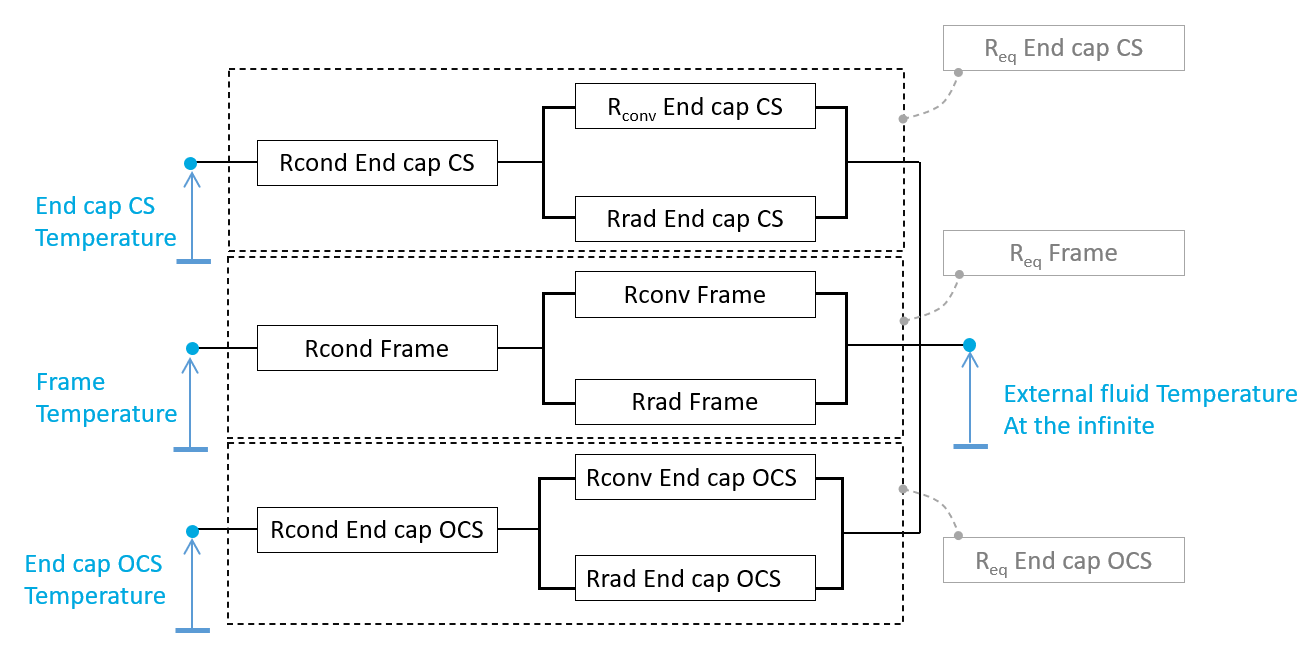

The global resistance between the frame and the external fluid shown on this graph corresponds to the thermal resistance network shown below.
Three main paths extract the heat from the machine to the external fluid, corresponding to three main components: the straight part of the frame, and the two end caps.
Each of these paths extracting heat of the machine is composed of several thermal resistances in series:
- The conduction through the material composing the part
- The convection and radiation occurring from the external surfaces of the frame.
In this network, the convection resistances are mixes of natural and forced components of the convection phenomenon.

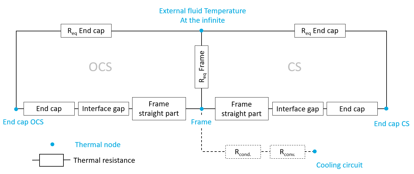

| The global resistance between the frame and the external fluid - Thermal resistance network |
| Thermal resistance network including the interface gaps between the frame and the end caps |
