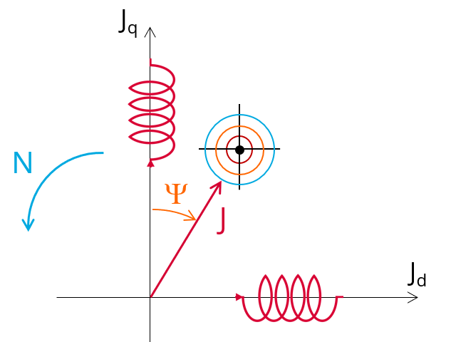

he aim of the test “Working point – Sine wave – Motor – I, Ψ, N” is to characterize the behavior of the machine when operating at the targeted input values I, Ψ, N (Magnitude of current, Control angle, Speed).
Hence, these three inputs are enough to impose a precise working point.
The resulting model is fully parameterized, and it is built in Altair® Flux® 2D environment, transient application.
| “Working point – Sine wave – Motor – I, Ψ, N ” illustration |
