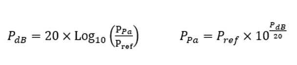

3.4 Displayed pressure range (dB)
The “ displayed pressure range (dB) ” ( Displayed Maxwell pressure range ) is only related to the displaying of results.
It allows to increase/decrease the range of non-zero contributions displayed in the Maxwell pressure harmonic decomposition map.
When one chooses a displayed pressure range equal to 50 dB, only the contributions within the range of 50 dB and below the maximum computed value is displayed.
Considering this referent value P ref , one can compute any Maxwell pressure value P Pa (expressed in Pa) from the ones expressed in Decibel P dB .
The relations between these quantities are illustrated below:
The default value is equal to 60. The range of possible values is [20;100].
