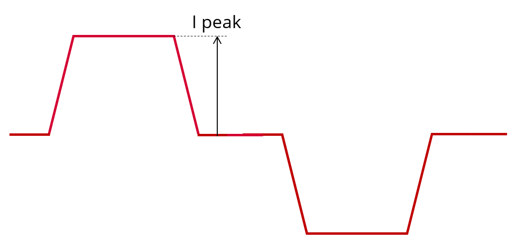

2.3 Line current, peak
When the choice of current definition mode is “ Current ”, the peak value of the line current supplied to the machine: “ Line current, peak” ( Line current, peak value ) must be provided.
| Definition of the line current – Peak value |

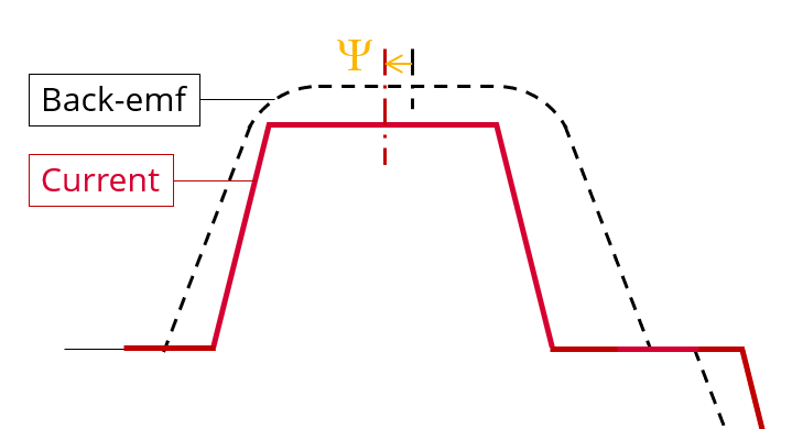

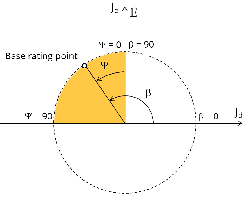

2.5 Control angle
Considering the vector diagram shown below, the “ Control angle ” is the angle between the electromotive force E and the electrical phase current (J) (Ψ = (E, J)).
The default value is 0 degrees. It is an electrical angle. It must be set in a range of -90 to 90 degrees.
| Definition of the control angle Ψ | |

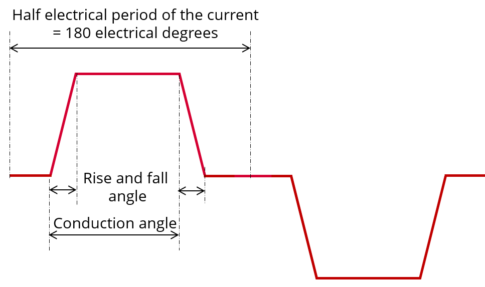

2.6 Conduction angle
The “ Conduction angle ” ( Electrical conduction angle ) is the time during which phase is powered with current.
The default value is 120 degrees (typical 6 steps control mode with a 6-transistor power electronics converter). It is an electrical angle. It must be set in a range of 0 to 180 degrees.
For more details refer to the following illustration “Conduction angle” and Rise and fall angle”.
2.7 Rise and fall angle
The “ Rise and fall angle ” ( Rise and fall angle of the current in electrical angle ) represents the time constant needed for current rise from 0 to the peak value of the current or current fall from the peak value to 0.
The default value is 6 degrees. It is an electrical angle. It must be set in a range of 0 to 90 degrees.
To be noted that the “Rise and fall angle” must be compatible with the “Conduction angle”. For instance, the “Rise and fall angle” must be strictly lower than half the value of “Conduction angle”. In any case, the addition of “Rise and fall angle” and the “Conduction angle” must be lower than 180 degrees.
| Conduction angle” and “Rise and fall angle” |

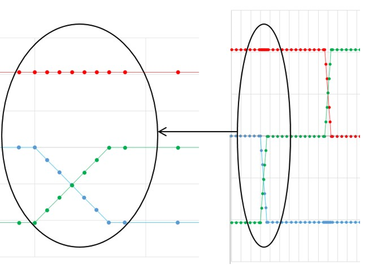

3.1 Minimum number of computations per electrical period
The user input “ Min. no. comp. / elec. period ” ( Minimum number of computations per electrical period ) influences the accuracy of results and the computation time. It allows giving a floor value for the number of computation per electrical period.
Note: In any cases, the real number of computations per electrical period will be higher because the number of computations within the rise and fall period is adjusted through an internal process. The distribution of computation points is illustrated below: Definition of the number of computations per electrical period.
The default value is equal to 87. The default value provides a good compromise between the accuracy of results and computation time. The minimum allowed value is 87.
| Definition of the number of computations per electrical period |
