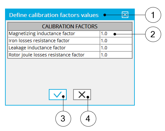

2.4 X-Factors
When “ Model refinement ” ( Refinements to improve the original model ) is set to “ X-Factor ” ( X-Factor ), “ X-Factors ” must be provided ( X-Factors applied on electrical components ). When the user clicks on “ Set values ” a dialog box appears allowing the user to set X-Factors values.
There are four X-Factors, “Magnetizing inductance factor”, “Iron loss resistance factor”, “Leakage inductance factor” and “Rotor Joule loss resistance factor”.

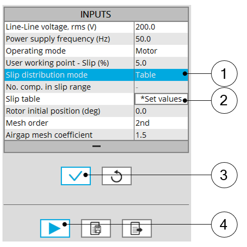

Slip distribution mode = Table
When “Table” is selected, the list of slips to be considered must be defined by using the next field: “Slip table” and by clicking on the button “Set values”.
Two ways are possible to fill the table: either filling the table line by line or by importing an excel file where all the slips to be considered are defined.
| Slip distribution mode = Table | |
| 1 | Select the “Table” option. |
| 2 | Click the button “Set values” in the field “Slip table” to open a dialog box to define the list of slips to be considered.Refer to the next illustration which shows how to fill the Slip table. |
| 3 | Button to validate and consider the user inputs |
| 4 | Button to run the computation |

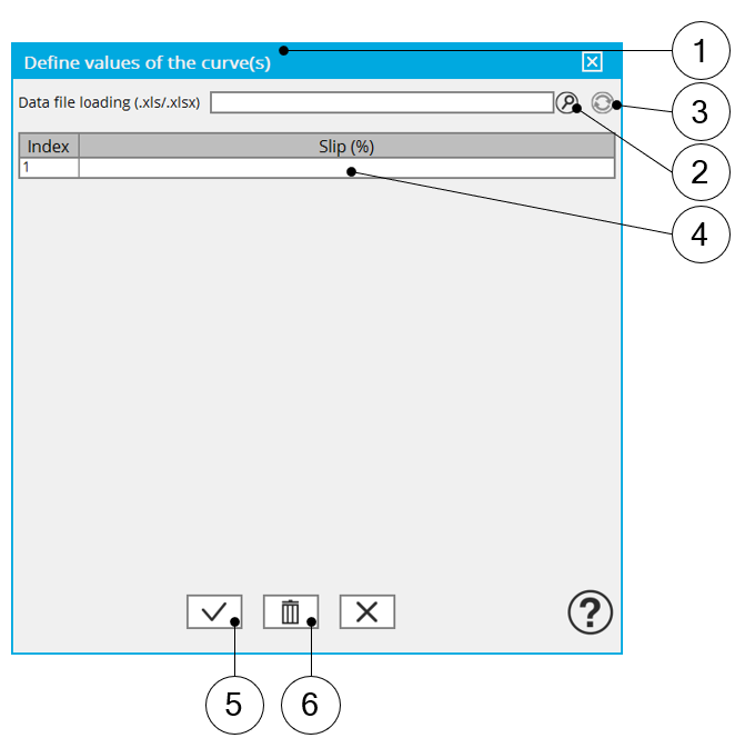

| Slip distribution mode = Table – Dialog box to define the list of slips | |
| 1 | Dialog box opened after clicked on the button “Set values” in the field “Slip table” |
| 2 | Browse the folder to select an Excel file which is defined the list of slips |
| 3 | Button to refresh the table data when the considered Excel file has been modified |
| 4 | Fields to be filled with data to describe the slips to be considered |
| 5 | Button to apply the inputs |
| 6 | Button to erase the data table |
Excel template used to import a list of slips is stored in the folder Resource/Template in the installation folder of FluxMotor. An example of this template is displayed below.
